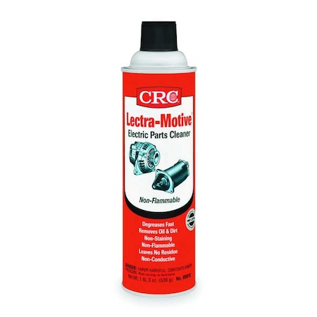

When I'm disassembling parts for maintenance on my '07 Griso, '03 Lemans  and '81 V50 I use a dremel with a brush tool to clean ground bolt/screw threads, electronics parts cleaner for the nut threads and frame where it's attached to.
I look at it as preventive maintenance that I only have to do once this lifetime.
