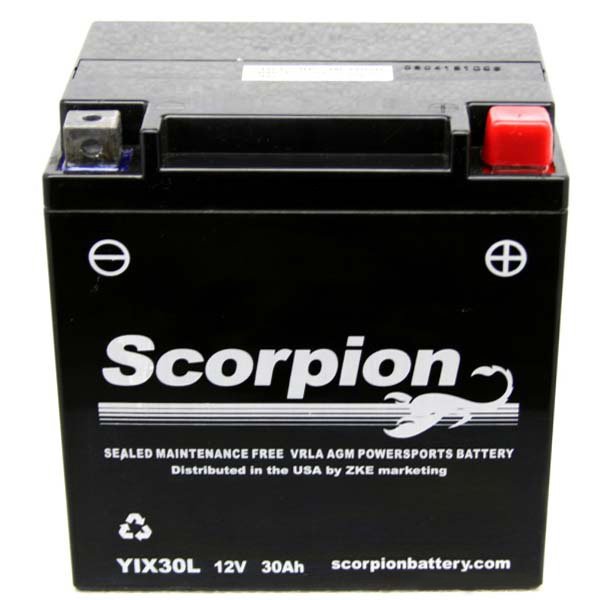

« Reply #8 on: December 27, 2016, 07:13:14 PM »
This is what I used. I prefer the AGM on things that vibrate... like motorcycles.
https://www.batterystuff.com/powersports-batteries/sYIX30L.html
I had to shim it a little as it's smaller than the the stock battery.
That's what I use too, except the (US made) Deka/Big Crank ETX30L.
