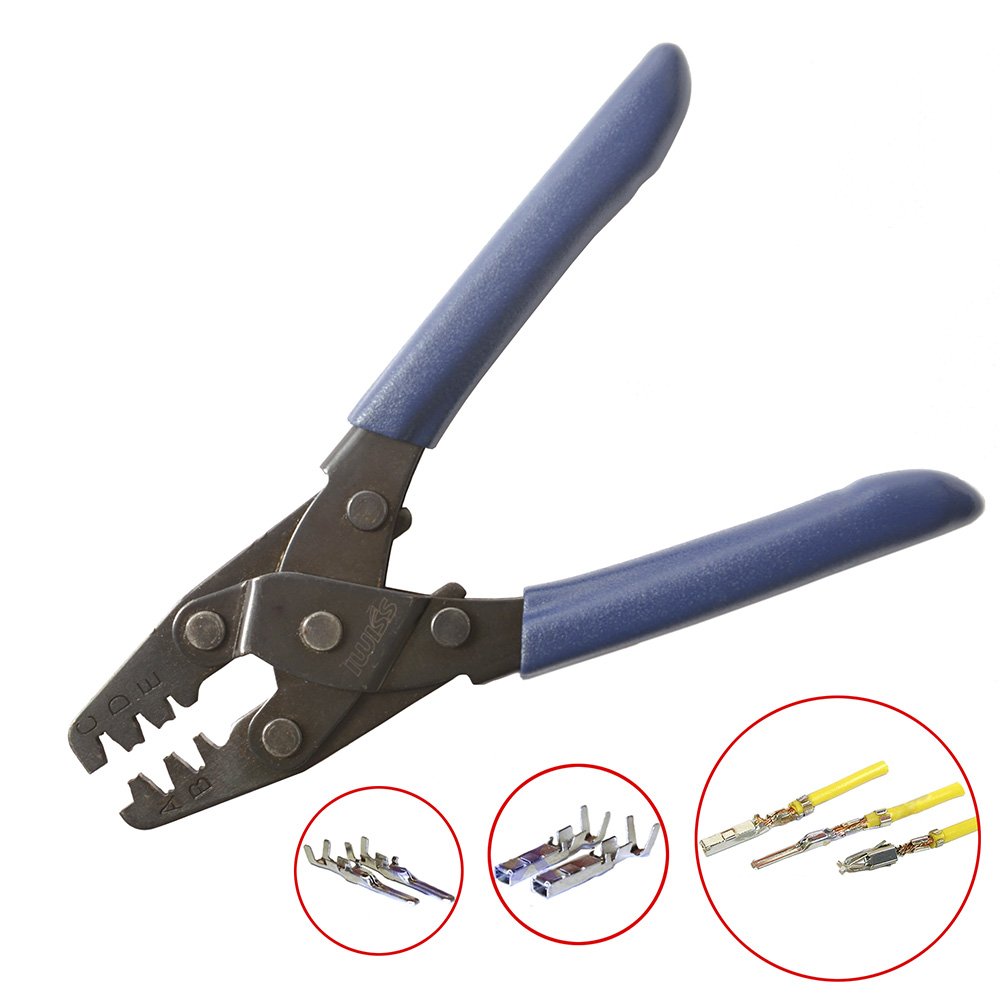

You don't have to, just replace the pins. A good electric / electronics supply will have them. Harpers has new connectorswith pins. Radio shack has the pin tool.

I'm sure Greg Bender could make you an "adapter" that is "plug and play". I'll be getting this one for my Convert:
Or he can supply the necessary Molex bits to do as MM says. An old section of brake line works great as a tool to remove the male pins.
https://www.amazon.com/Connector-Remover-Computer-Extractor-Sleeving/dp/B0094MIS9U/ref=sr_1_2?ie=UTF8&qid=1490497662&sr=8-2&keywords=molex+tool
Getting the right crimper makes a huge difference. If you get a simpler one like below just take your time and you can crimp away.
https://www.amazon.com/DR-1-Crimper-DELPHI-Terminals-Barrel/dp/B00GD03NI2/ref=sr_1_65?ie=UTF8&qid=1490497800&sr=8-65-spons&keywords=molex+crimp&psc=1
