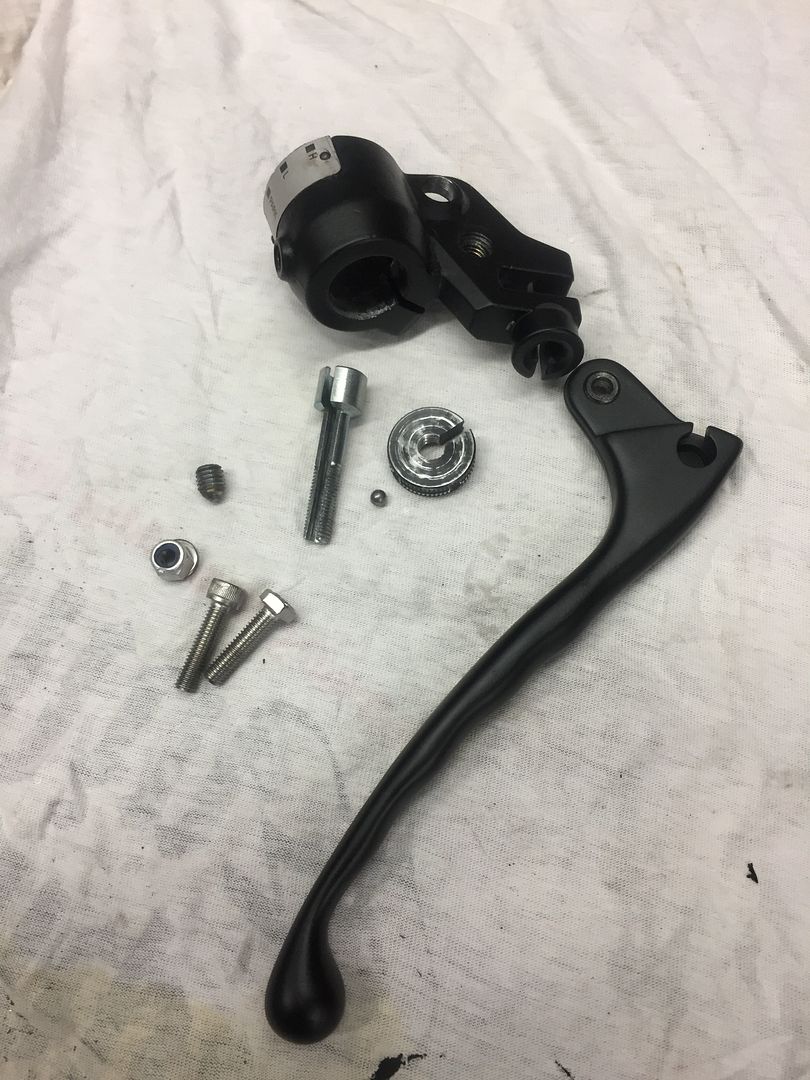

Re: 1977 Le Mans Rebuild getting started
« Reply #220 on: October 24, 2017, 10:08:45 PM »
assembled the rear caliper
new rigid rear brake line
attached the zinc plated cable guide
assembled the clutch perch / lever
grease the spring and ball
handlebar lock screw
switches cleaned up
sanded off some of the powder coat on the bar, too tight for the switches to pass over
There are two cut outs under the left hand handlebar, forward one for the headlight switch
Scrape down the paint for the ground lug in the switch to make contact
Assembled the front master cylinder
Master cylinder. switch and throttle slide over the right hand bar
« Reply #237 on: October 31, 2017, 09:35:23 PM »
A couple corrections, I had fitted rubber bumpers to the bottom tabs adjacent to the battery that the side cover pins pass through (bumpers on the V7 Sport), there should be just nuts and ground wired connect to the pin  / nuts
1st I sanded off the powder on the tabs
Same on the opposite side
Fitted a used inner splash fender, can't get new repros right now so this will do for the time being
Rubber washers
and the wire retainer on the wheel side
I had the rear master cylinder to splitter hose incorrectly routed, should be just behind the battery
and fitted the transmission breather hose
Now to finish the carbs and fit the distributor / electronic ignition, install the dash and instruments, wire harness,........
