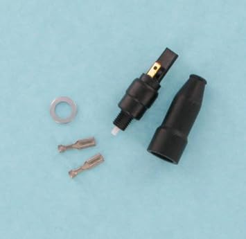

« on: June 19, 2017, 01:53:01 PM »
P/N 28741100
I put a new one on the Lario a couple of years ago and it's already failed. I wouldn't mind so much, but Harpers gets $55.87 plus shipping for a switch that is going to fail again. This is two switches in 4 years.
Has anyone figured out a work around with a reliable switch?
TIA
Edit to add picture..
2017-06-19_02-29-28 by Charles Stottlemyer, on Flickr

Edit: before punching the buy it now button, I looked at the thread and it appears the OEM is M6, not M10. Whew! Almost wasted $12.. :) :)
2017-06-20_07-48-17 by Charles Stottlemyer, on Flickr
« Last Edit: June 20, 2017, 06:59:56 AM by Chuck in Indiana »
  • Posts: 29662
Re: Stupid Lario brake light switch
« Reply #19 on: June 20, 2017, 08:01:35 AM »
Ok, here's the issue.
2017-06-20_08-53-48 by Charles Stottlemyer, on Flickr
The bottom tab doesn't quite touch the plunger. All I have to do is bend it down a few thousandths until it does. Reliably. :smiley: Then, figure out how to recrimp the switch back together. Maybe some sand blast and metal set epoxy..
King.. this case is closed. Mystery solved. :wink:
