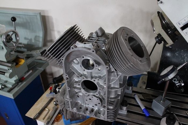

I bought a new set of of rear shocks (Ikons's) and also picked up a set of 20 mm Showa cartridges which I would like to put into the Eldorado forks one day but that would be a fairly involved machining operation to the lower part of the fork legs (but have figured out a way to do it including counter boring inside the front axle hole if need be)
Getting the bike moving under its own power might be a higher priority (I did bring back two sets of PHF 32 mm Dellorto's on my last trip back to NZ and got a set of the later alloy manifolds from Germany that could have sleeved added)

A pretty bike was not what I was after but never could get the alloy to a 'been looked after for 40 + years' so ended up doing what I had considered but did not want to do.
It might become a new trend, an original paint and chrome bike with vapour blasted castings.
The bike must have sat for a long time (the crankshaft was rust covered) and one side showed more oxidisation (grey in the alloy that I could not remove with either acid or soda blasting) so maybe sat against a wall or something.
Rick, yes the weight is to offset the Gilardoni 949cc pistons, maybe I should have bought a crankshaft out of a 88 mm bore bike and used that instead.
As above, it was that or remove weight from the pistons or from the rod big ends and a lot of weight... I will phone today and see what is happening with that two weeks after ordering it.
The vapour blasting is nice but nothing like an original finish, the final drive I did myself and looks much more realistic, a pity I could not get the rest of the castings the same.

My concern was, it is easy to get onto that slippery slope, clean cases, old fasteners, whoops that frame paint looks a little worn..... and those dull hubs and rims and................ ..  :grin:
I rode down to Brisbane/QLD (On the Africa Twin DCT) to pick up some bits including long 8.8 M8 bolts which I will turn and then grind to make M8/M6 step studs to suit the M8 Eldorado engine case to M6 later oil pan.
I can see (I think it was Joe W) what was meant as far as drilling that later pans 4 holes out to 8 mm to suit the Eldorado and getting oil leaks, a bigger hole would be dangerously close to the oil passages in the pan.
Step studs will avoid that but nothing off the shelf was available.
Of course, later yesterday afternoon, I got a call from the same vender saying the 5/8" ARTU drill had arrived from Sydney so jumped back on the AT and picked it up.
I stopped in at a large welding supplies while there and asked the beardless 'hipster about some 309 filler wire to be informed all they could sell me was a $211 tube of wire so I passed on that.
I will T.I.G the crankshaft to hold the Mallory metal inserts and use Loctite 660 or some form of wick in locker afterward.
The crankshaft will then go back for a final spin check but cant see the point once the weights are inserted never to come out (I hope)
I've done it that way on every oil filter conversion (five so far), never had any issue with oil leaks. <shrug>

I will get back to it, maybe drill the pan to 8 mm when I get back from NZ next week.

In the time it took me to drill two holes, Charlie M has probably rebuilt a complete bike and been on quite a few rides.
I got back from the old country and am back onto that crankshaft, I can say with confidence nothing will stop an ARTU drill.
I should have spun the 1/2" drill faster but found the 5/8" went very well at 575 rpm.
All I need to do is T.I.G around the perimeter of the holes with either 309 S/S or maybe ER70S, I might then try and hydraulic Loctite 660 into the clearance gap or maybe a wicking Loctite.
Once this is done and it has been checked spun up (A bit late by then ? ) I won't have to deal with any more people or companies.
It means I have everything to finish the bike from the cylinder heads to the GB wiring loom, yikes.

I had to look up the ARTU drill. It seems like it is a brand name. Which kind of drill did you use? Cobalt or multipurpose?

Yes the brand name is ARTU.
I believe is was this version.
ALLROUND BOHRER
Tough multi-purpose drill bits for concrete, brick, ceramic tiles, hardened steel, wood and even glass.
I still need to secure the plugs, even at 3000 rpm that will be 50 crankshaft revolutions per second, I have ordered some 309L filler wire and will weld to the crankshaft, how much I do not know yet as I would like to use some form of Loctite also maybe 638.
If they departed the crankshaft at speed it might be more then entertaining.
