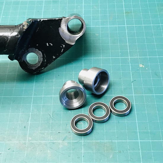

The original 14 mm shaft and bushes were quite worn and not sure how it ever lined up with the welded arm 8 mm past the one on the gearbox and also mismatched the other way.
The bearings are installed (21x12x5) and I had a spare shaft (15 mm from a stock shift) I put it up between centres, machined to 11.99 mm and the end ground for two flat and the end machined for a 6 mm lock nut.
If they ever wear out replacement will be off the shelf parts with no extra work, it will need a machined arm for attachment to the shift arm on the gearbox.
The brake and shift pedals have the same bearings.
