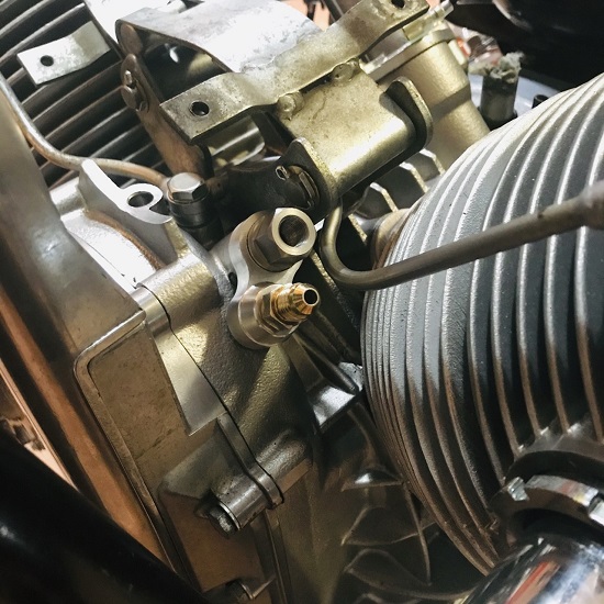

That all worked out well, the gauge port will also be used to inject oil before the first start.
The sealing washers got a wipe with WellSeal both sides.
Yes those are brass washers on the generator cover and generator bracket clamp pins.
A PO had tightened the generator plastic cover bolts until the small washers had imprinted the cover, I guess in an effort to stop them loosening.
The new washers cover the damaged area's, under the washers are collars that the 6 mm bolts pass through, they bare on both the threaded bracket and the washer so when the bolts are tightened there is no compression for loosening, the cover is retained by default......... in theory.
Final generator to bracket seating done and torqued to 30 n/m.
The holes have deep M8 thread inserts, custom M8 /1.25 studs and the Nylocs are the taller version.
The studs also got Loctite 660 to fill any voids between the threads.
Although firm they should still be removable with effort.
I am hoping for fit and forget.

I think there was a piece of angle iron holding the battery down when I got the bike but to long ago to remember.
With the shoulders on the studs, when the nuts are tightened the top clamp rests on them securing the battery (felt under the top bar and in the tray) but can not over compress it.
Fit and forget I hope.
The plate (original black paint) and battery tray can go back into the bike (again)
LesP
Re: Eldorado and the quest to ride a Moto Guzzi for the first time.
« Reply #298 on: March 18, 2020, 02:15:07 AM »
Radius form tool and end prep for live centre/center.
M6 to attach to tray.
A modified M6 bolt (upward) holds the tray to the frame plate, a brass insert in the tray with a M6 thread holds the tray down, the M6 thread above the insert (25 mm of) threads into the hold down studs.
M8 - 1.25 die nut.
Live centre/center radiused form tool.
10 mm hex... 0° - 60° - 120° - 180° - 240° - 300°
