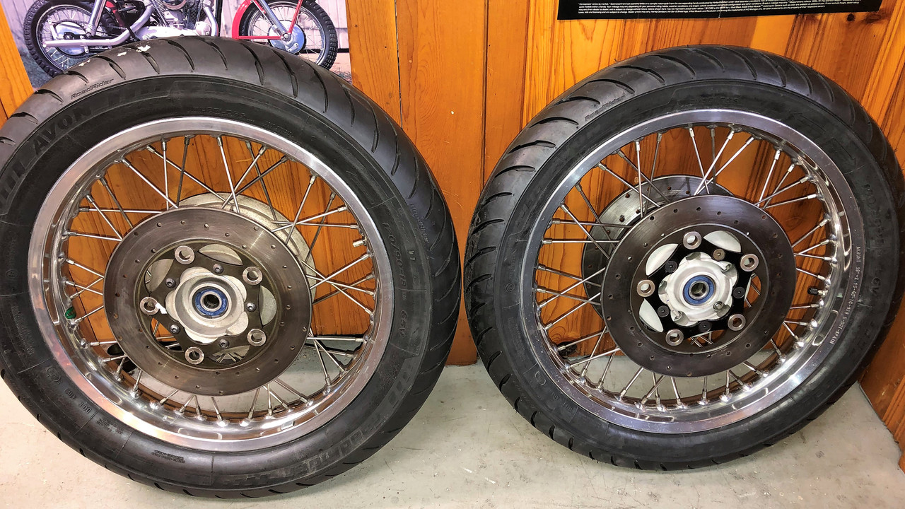

I always like to finish the wheels first.  Having the wheels ready to mount feels like a big step in the right direction.
Although the wheels were very crusty I was very impressed with the condition of the rims.  There were no hamfisted tire changes in their past.  The wheels were also very true and the spokes were consistently tightened.
New rubber, bearings, quite a few hours of cleaning of the wheel components, and a good polish of the spokes and rims resulted in this.

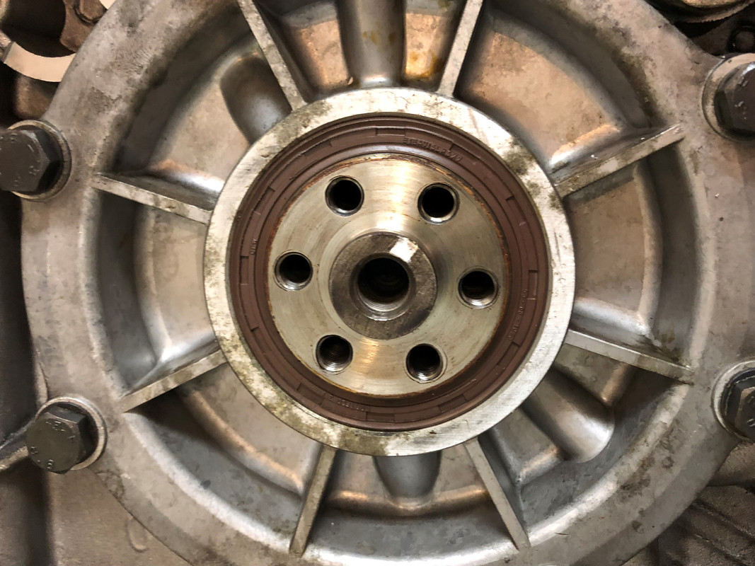

Bike is stripped for cleaning and inspection.  Since the pictures I have pulled off the clutch/trans housing to inspect the clutch, and check for signs of oil leaks.

« Reply #45 on: May 29, 2019, 03:50:13 PM »
The clutch plates have very little wear at 7.7 mm thickness, which is consistent with the bike's mileage of 15,000 miles,  but were oil soaked.  The oil was coming from the transmission side, possibly migrating in from the push-rod.  The engine side of the flywheel was bone dry and there is no sign of any oil leaks on the engine side of things.

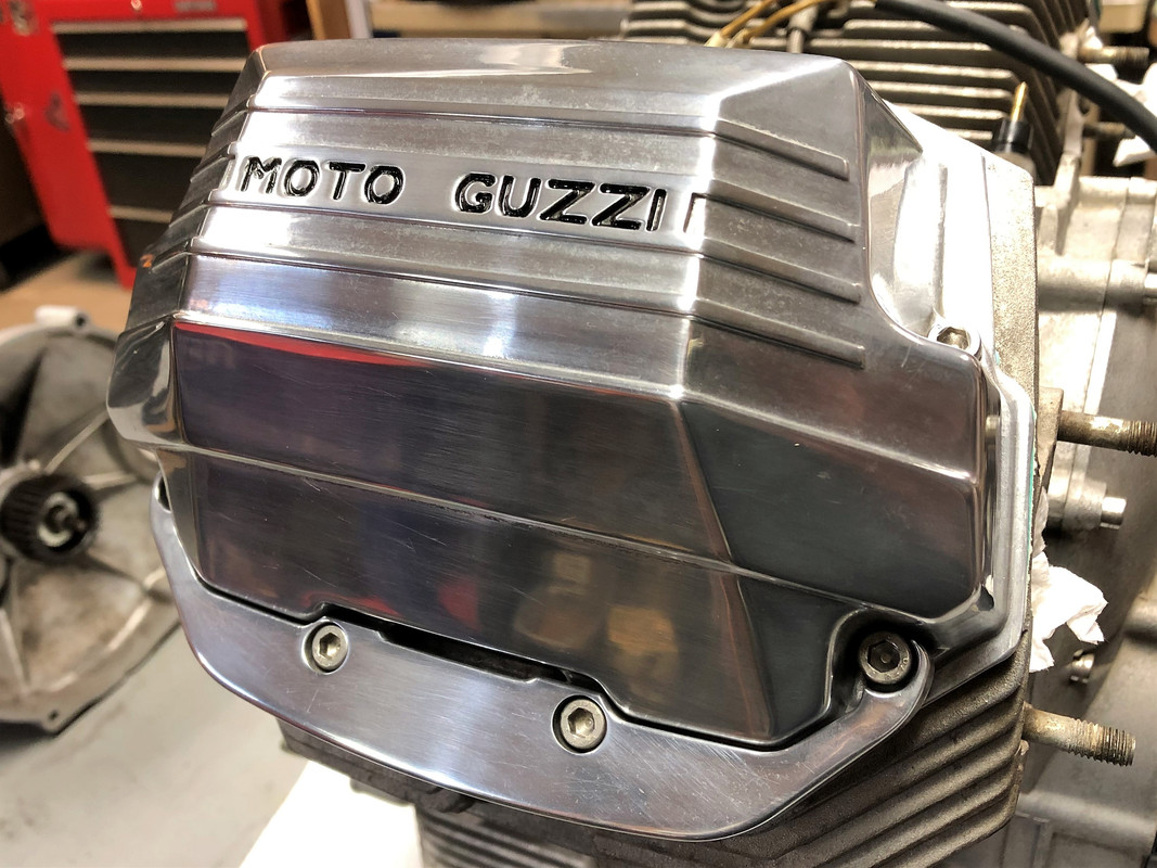

As pretty as the motor is going to get.  I spent the day scrubbing it.  Looks good, but not pristine.  It will go right along with the "rejuvenation" concept.

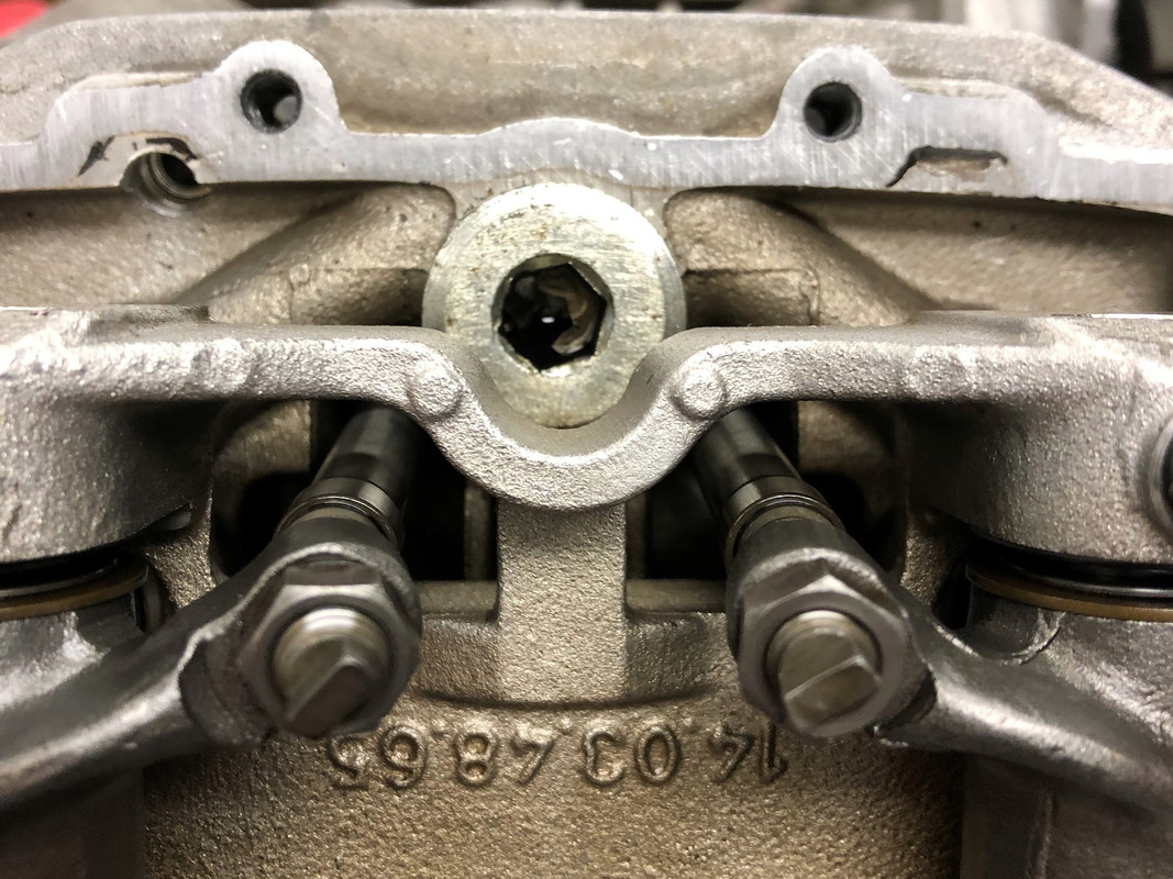

When adjusting the valve lash I was happy to see that no ham fisted gorillas had been in there before.   :thumb:

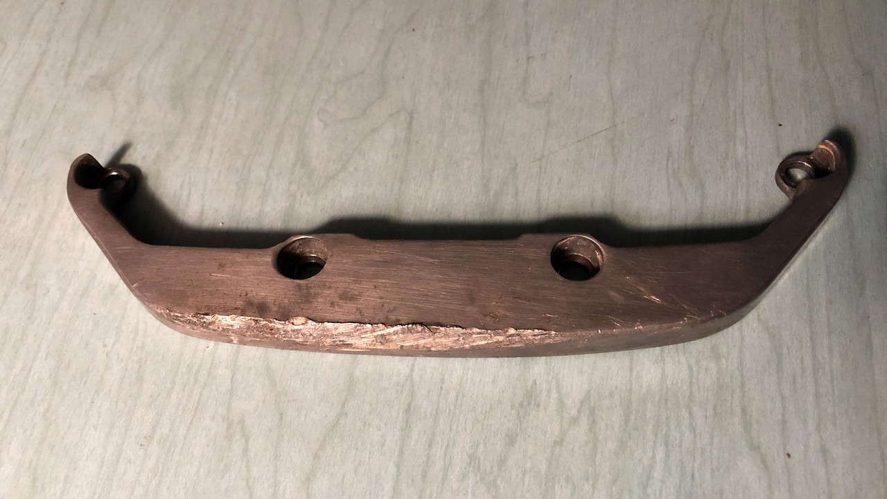

Also I am forever grateful to the individual that saw fit to add head guards.   When the bike went down on it's left side the guard performed it's sacrificial work!
I had a spare head guard that was painted black.  I put it in stripper for a couple of hours (that paint was tough) and then gave it a good polish.

New clutch going in.  The old clutch exhibited very little wear but the friction plates were oil soaked so I thought it was best to replace.
