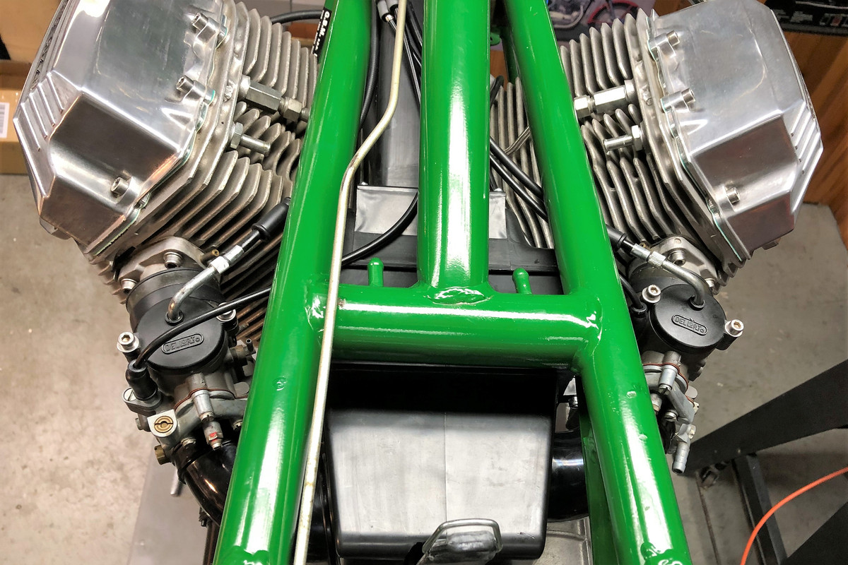

I checked the carbs over and found them to be in exceptional condition.  There was no corrosion  from long term fuel exposure.  I just gave them a light cleaning and installed them and the throttle and fast idle cables today.

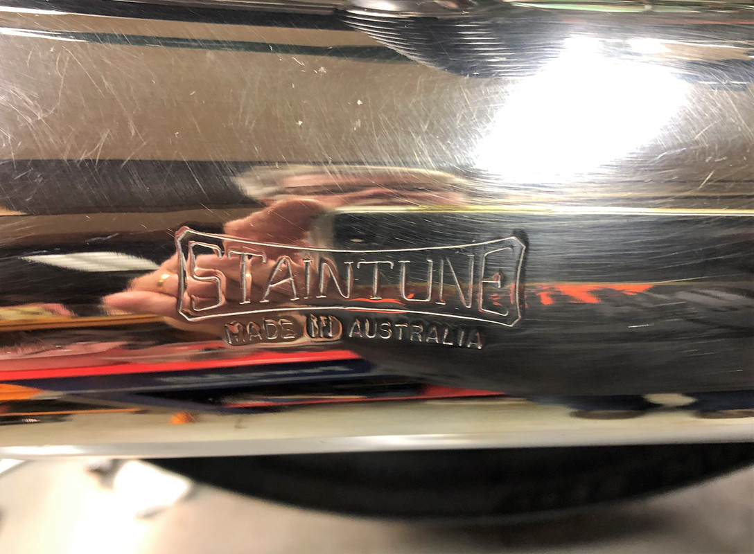

I polished the  un-obtainium 1000S Staintunes to my satisfaction.  I didn't want them to look brand new.  If I had wanted that look I would have sent them to a pro.  I am happy with the result.  The level of shine and remaining warts are in keeping with the bike.
The Staintune exhaust system is very well made!  I appreciate the extra pains they took to emboss their muffler clamps.  And check out the flare on each side of the clamp.  This really aids in the ease of sliding on the clamps.  First class!
I have heard they sound great.  I am really looking forward to hearing them this summer.

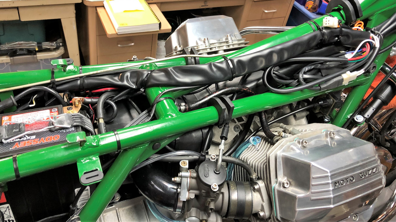

I decided to spring for one of Greg Benders fabulous wiring harnesses for the 1000S.  My old harness was in fairly good shape, but had a few areas that needed help.
I was reading through Greg's website and he mentioned he was looking for a Series 2 1000S wiring harness to copy as he hadn't had the opportunity yet.  My  harnesses were off the bike, therefore it made complete sense to send it to Greg so has the opportunity to copy it.  I will end up with a more reliable wiring setup for the bike.  Win win I would say.
I started wiring over the weekend.  The workmanship of the harnesses is absolutely top notch!!
Quite a bit to it actually.
« Last Edit: July 15, 2019, 04:52:36 PM by Dave Swanson »

I can't say enough good things about Greg Bender's wiring harnesses - perfection!   Everything worked perfectly right out of the chute.  I am pleased to report that I made no errors during the hookup due in no small part to having a "reference"  1000S a few feet away!
Instruments go in tomorrow.  Then I will add some gas and fire it up!
