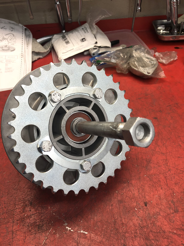

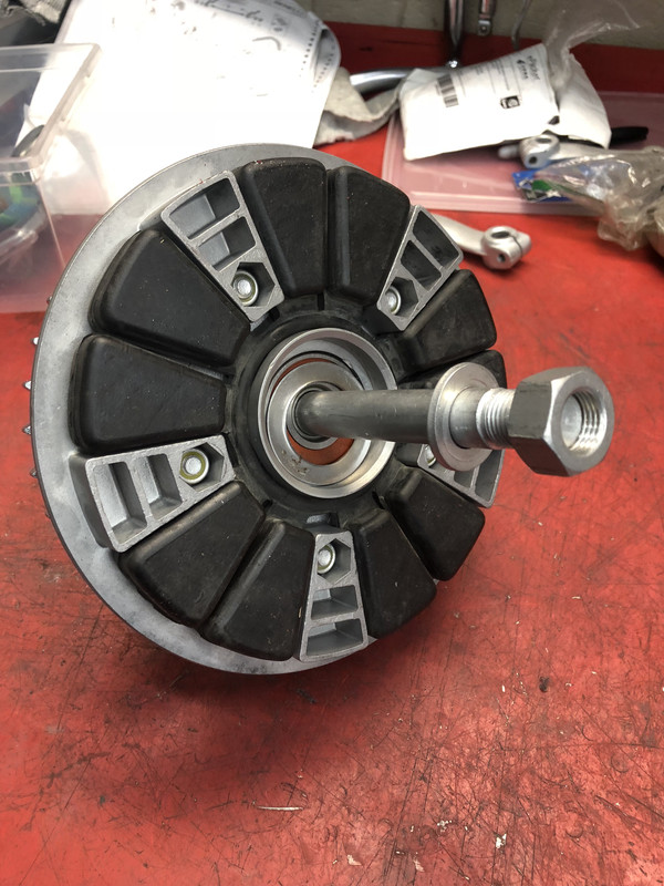

Rear sprocket carrier assembled with new bearings and a new rubber damper, sprocket and bolt lock tabs

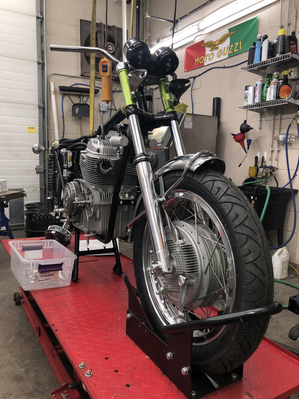

On to the front wheel, Benelli uses some 7mm bolts on this bike like on the chain tensioner and the brake arm pinch bolts, a trip to the bolt shop for Monday
Zinc plated axle needs some plating skimmed off, emery cloth on a spinning axle
Wheel in position, I had to let the air out of the tire to clear the fender support nuts, the Pirelli is a bit too wide for the bike but it does fit, just

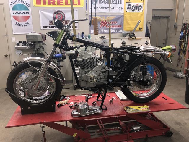

Starting to look like a motorcycle again

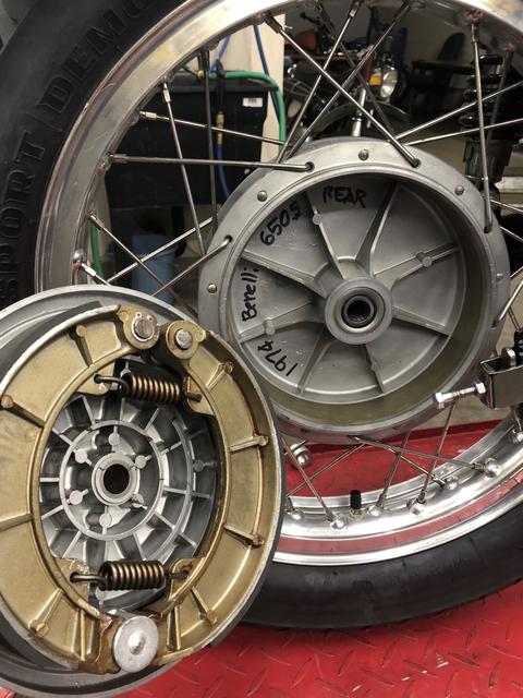

Fitting the rear wheel
Had the rear brake shoes relined and arced
The Benelli uses twin torque arms for the rear brake plate

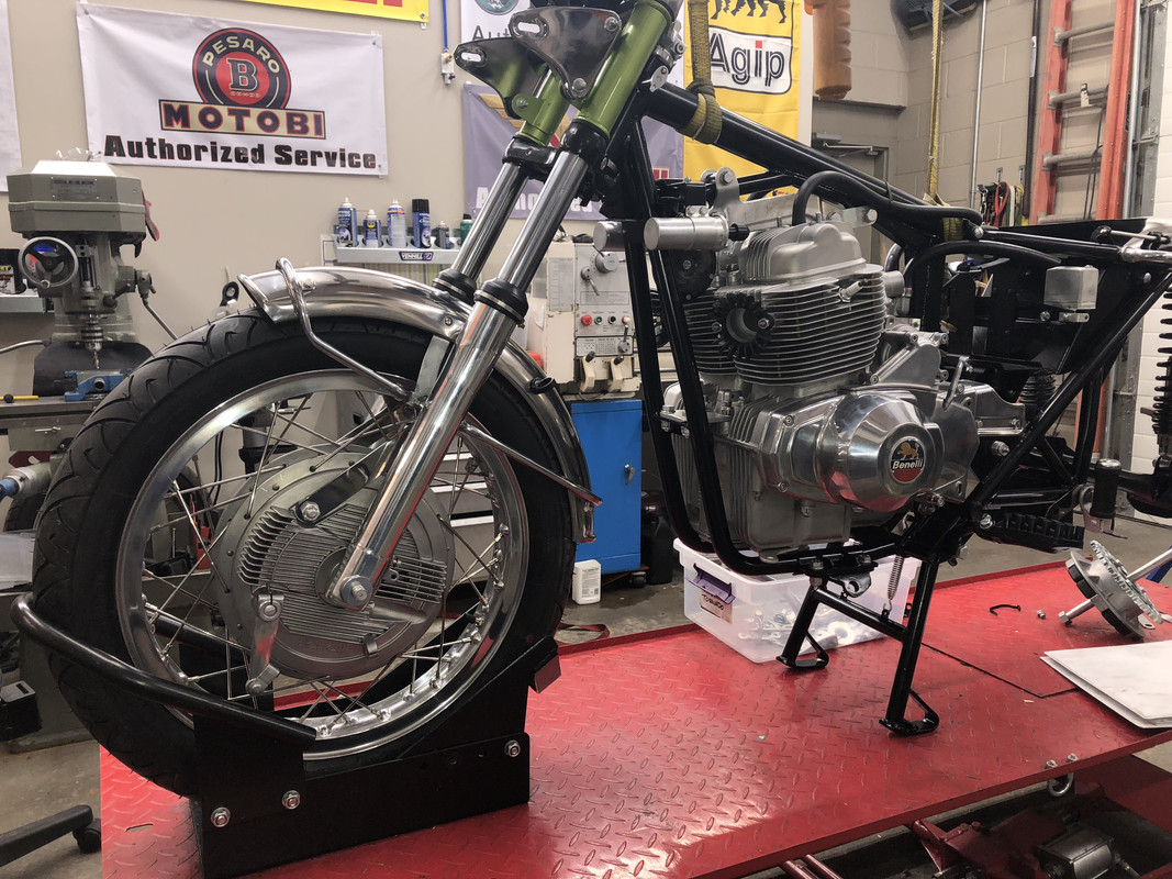

Its always a milestone moment in my mind when the bike is back on its own two wheels

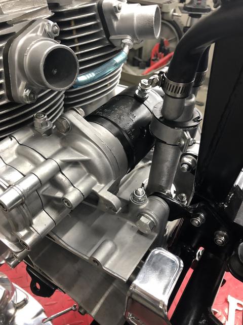

Installed the Bosch starter motor, scratched my head for an hour trying to get the starter drive shaft spline to fit into the engine chain case, the cap on the motor can go on either side of course I had the cap on reversed, flip it over and in went the starter
And this horseshoe bracket is not symmetrical, and it too was on backwards

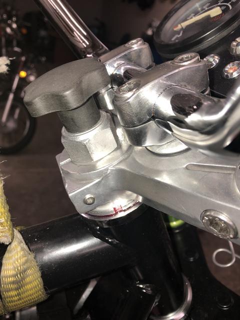

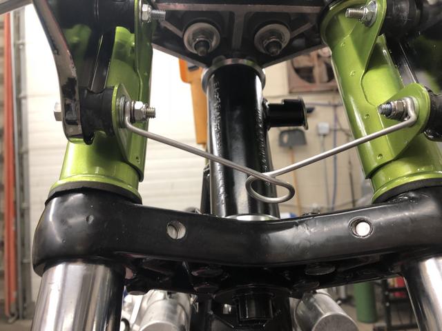

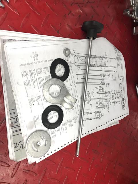

The steering damper is a simple friction device that compresses two plastic discs between metal plates, I never have understood how restricting the movement of the steering is a good or necessary thing but this style was used on a lot of Italian motorcycles
Rear brake pedal passes through the frame in the usual manner with this crank arm that connects a rod to the rear brake control arm plus the leg on the crank engages a pin activated brake light switch

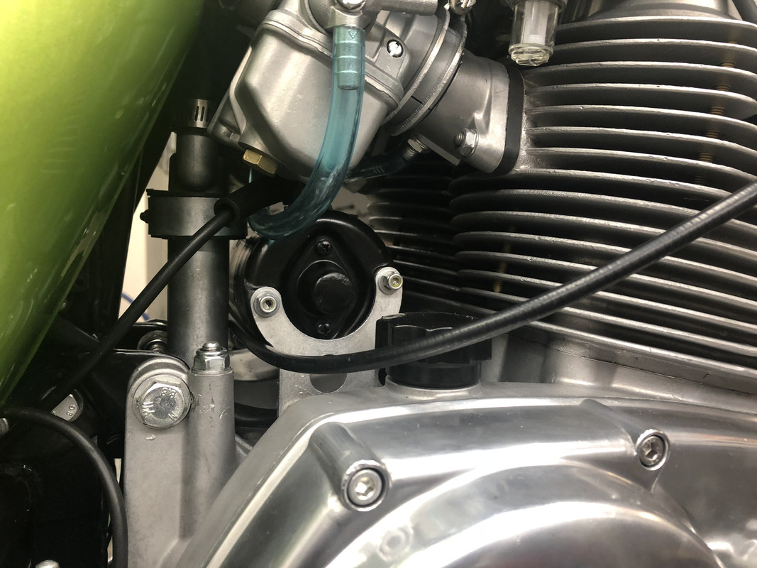

New tach cable fitted to the front of the engine case that engages a gear on the cam shaft
Up through this metal cable guide and into the back of the tach

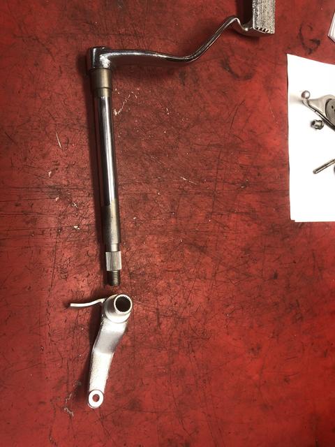

New foot rubbers for the kick starter and shifter, the kick starter sits at a crazy angle

Is there any way you would consider leaving the kick starter off ?

On the two I've had here, the lever actually sits a bit lower yet, almost horizontal.
Brochure photo shows it the same way.

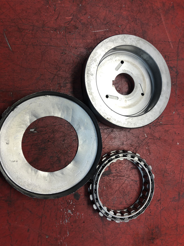

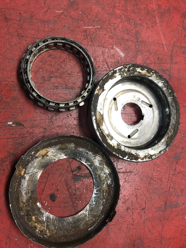

I split the sprag clutch good thing I did, full of rust
Cleaned up and I think it works fine now, the sheet metal cover tabs broke off so I had to spot tack weld the cover to the steel out casting and then file down the little welds to just hold the cover on.

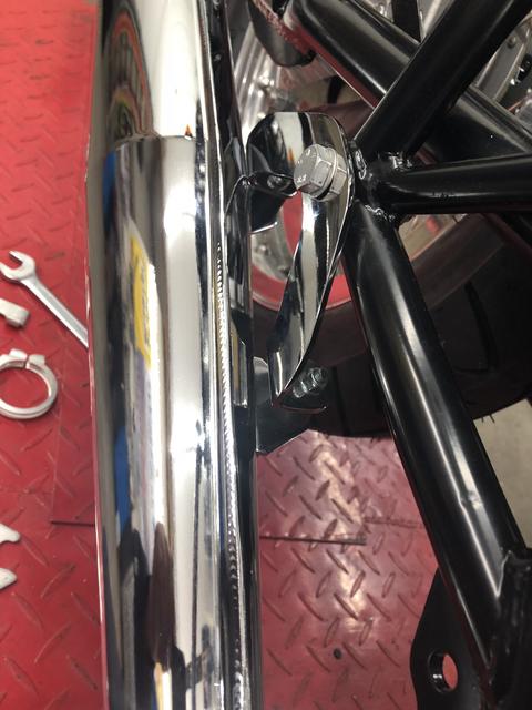

right hand control perch, lever and start button fitted, I found some big fat grips on Ebay that looked right for the Tornado

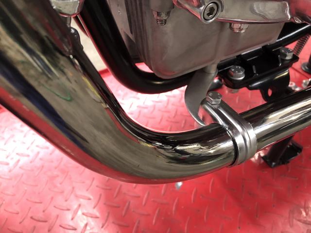

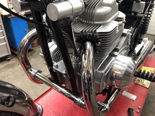

Installing the new headers and cross over, they came as raw steel from Germany, new exhaust gasket and replated header crimp plates
Its a pretty rigid exhaust mounting
Muffler brackets carry the muffler with two silent blocks but the passenger foot rests I bought turn out to not be correct for the Tornado, I need to find another type of footrest

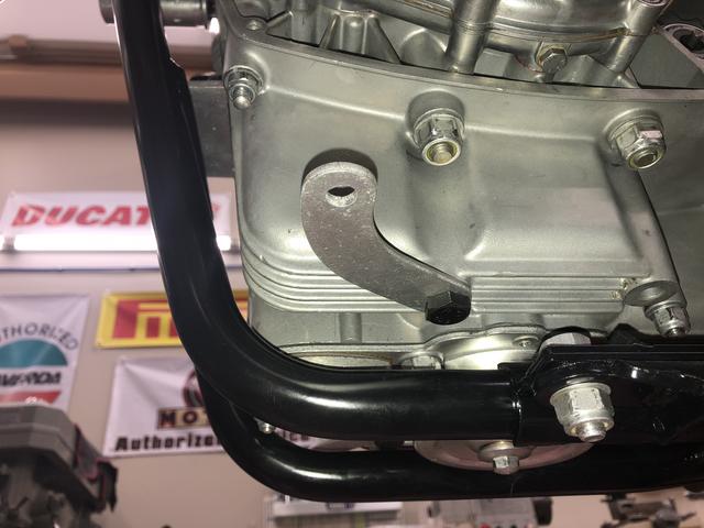

As I was taking the side view picture I got to thinking how is the centre stand flipped down?, and then the penny dropped, the tang has broken off the side stand
I need to get some steel rod, break out the oxy/acet form a tang and then grind off the remnant and weld it on.

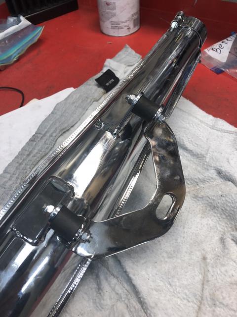

« Reply #48 on: November 10, 2018, 07:33:03 PM »
Silent blocks installed on the mufflers and support brackets

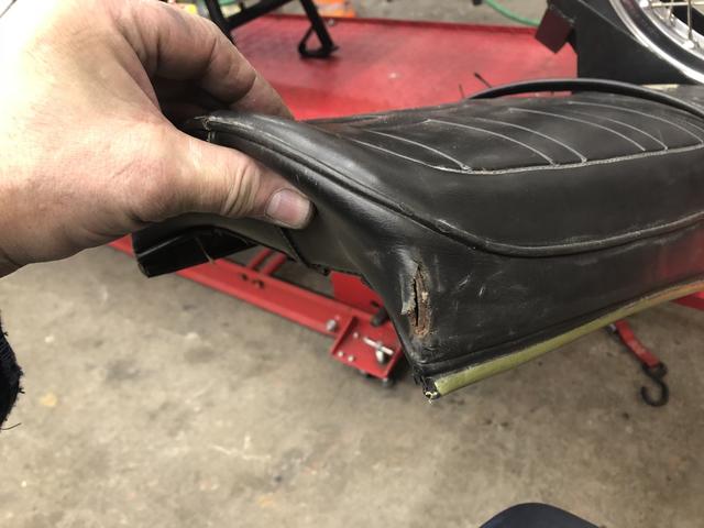

I found another used seat on Ebay a couple years ago, not too bad but lots of surface rust
Will need to repair the cover, no reproductions available
Vapour blasted the seat base and I painted with POR-15 gloss black

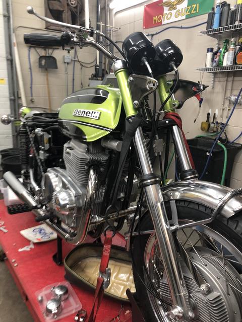

A sneak peek at the gas tank on the bike, I need to polish the stainless steel tank trim
I like this bright green colour a lot more than the original gold / black colours

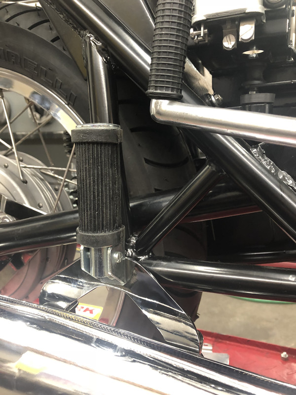

I found a set of rear foot pegs on Ebay that look similar to the originals (I only have pictures from Google of what the rear foot pegs look like)m in any event they were listed as fitting Ducati so the price was in line with the Ducati label....
and they don't foul with the exhaust in the down position

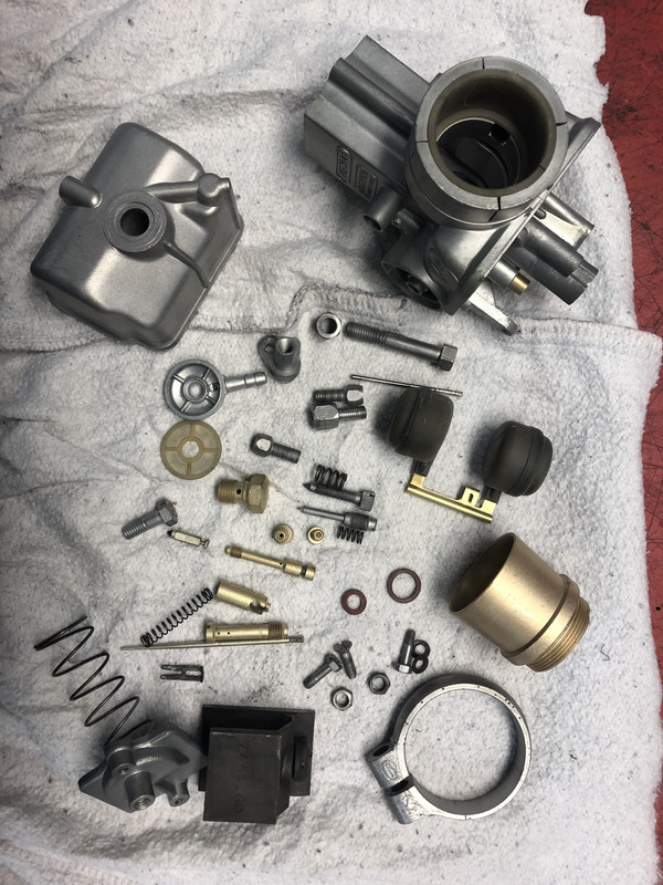

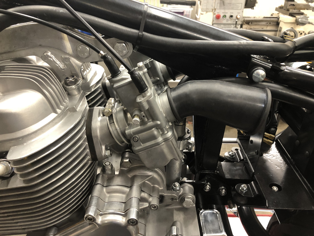

Detlef Burian sent me a carburetor to match to match the one that came with the bike, its a VHB 29 without an accelerator pump, all parts there if a little gummed up
Cleaning each piece in the vapour blaster then into the ultrasonic cleaner and it all comes out nice and clean
carb kits fitted,
Replaced the hardware with new pieces

I got the carbs together today and back on the bike, these particular VHB's are hard to find, Detlef Bauer had the rubber intake boots in stock and supplied new cables for throttle and choke.

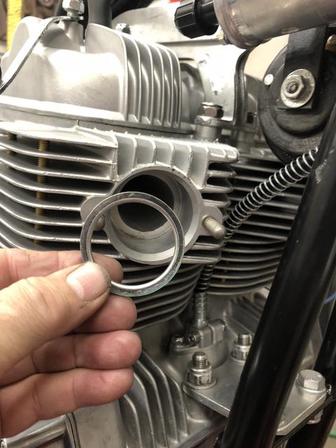

Typical Italian bike of the era with no air filtration, I am going to see if I can keep the rubber boots and fit some form of air filter at the mouths of the boot that will be hidden behind the side covers
The Benelli intake manifolds have a balance tube between them like the laverda SF1 I have, is this supposed to balance the intake pulses?
I got seat base painted with Por-15 epoxy paint, Por-15 sticks like powder coat once cured
The original foam is still solid and reusable
I found a local business that repairs vinyl and leather, last year I got into my car with a small flat blade screwdriver in my back pocket and promptly stabbed the seat of my car, the seats are perforated leather and the repair the mobile shop did was amazing. I had the same tech repair my Laverda SF seat, he fixed to rips and re-stained the black vinyl, it came out looking like new. I am taking the seat cover to them on Friday, hopefully they can restore the vinyl to like new. I am hoping they can restore the plastic chrome strip molded into the seat sides. The inside of the cover is in real good shape.
Rips at the front where the cover stretches over the sharp edges of the seat pan, the metal needs rubber sleeves installed over the edges before the cover is reattached
A couple small rips in the cover
I will post some 'after' pictures when I get the seat cover back
On my Tornado, I cut a 2" length of steel exhaust pipe that had an o.d. the same as or close to the i.d. of the rubber boot. Hose clamped that 1" into the opening of the boot, then installed UNI foam pod filters over the protruding 1".
Re: Building a Benelli 650 Tornado
« Reply #56 on: November 15, 2018, 10:14:14 PM »
I like that idea!  Thanks

I finished installing the throttle and choke cables and freshened up the choke lever
Installed a new steering lock
And installed the reproduction side cover emblems and the side covers
and a locking gas cap
Now back to waiting on few last parts and the seat to  be restored. I found a side stand from a tip on the Benelli Forum, it was for sale on an Italian web site.
