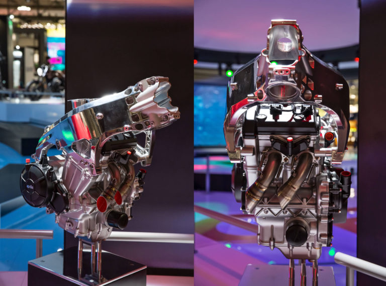

That looks serious.  Downdraft intakes, water-cooled, ultra compact.  This could be the basis for a fast, lightweight sports bike.

How do you get at the valves to adjust them?
Through the nose. You pay through it for someone else to do it.

So where are the valves and how do you get to them for adjustment?
Step #1: remove engine.

That same first step is needed on at least one other Italian bike I'm familiar with.
A lot of these bikes don't need a lot of attention to clearances. I wonder about this one

Maintenance accessibility of the engine is often an overlooked design criterion for designers who are seeking the most compact and lightweight machine, such as that pictured above.  My KTM 390 Duke is a lovely bike, but it suffers mightily from this "dense pack architecture" phenomenon, so much so that even changing a spork plug is an ordeal requiring much disassembly.  Checking and changing valve shims is, for the home mechanic, something of a torture.
We here often take it for granted, but Guzzi owners should be thankful for the superb accessibility of Guzzi cylinder heads and the overall ease of access and maintenance thanks to Guzzi's unique engine configuration.  Working on a KTM or Aprilia will give you a renewed appreciation for Guzzi!!
Due to the very short valve train on DOHC motors there is literally not much room for movement unlike a pushrod motor. So you'll find valve check intervals will be around 20 000kms (12 000miles) and it is perfectly normal for the motor to not actually require a shim before 60 - 80 000kms. Looking at that motor you simply go through the top after pulling the airbox and tank some of the DOHC are setup so you don't even bother the cam chain when doing the shims.

If you take a look at the pictures of the engine in the frame you'll understand why I asked.
https://2yrh403fk8vd1hz9ro2n46dd-wpengine.netdna-ssl.com/wp-content/uploads/2018/11/2018-aprilia-concept-rs-660-first-look-4.jpg

24,000 mile valve adjustment.
Most riders will never ride far enough to have it done.
