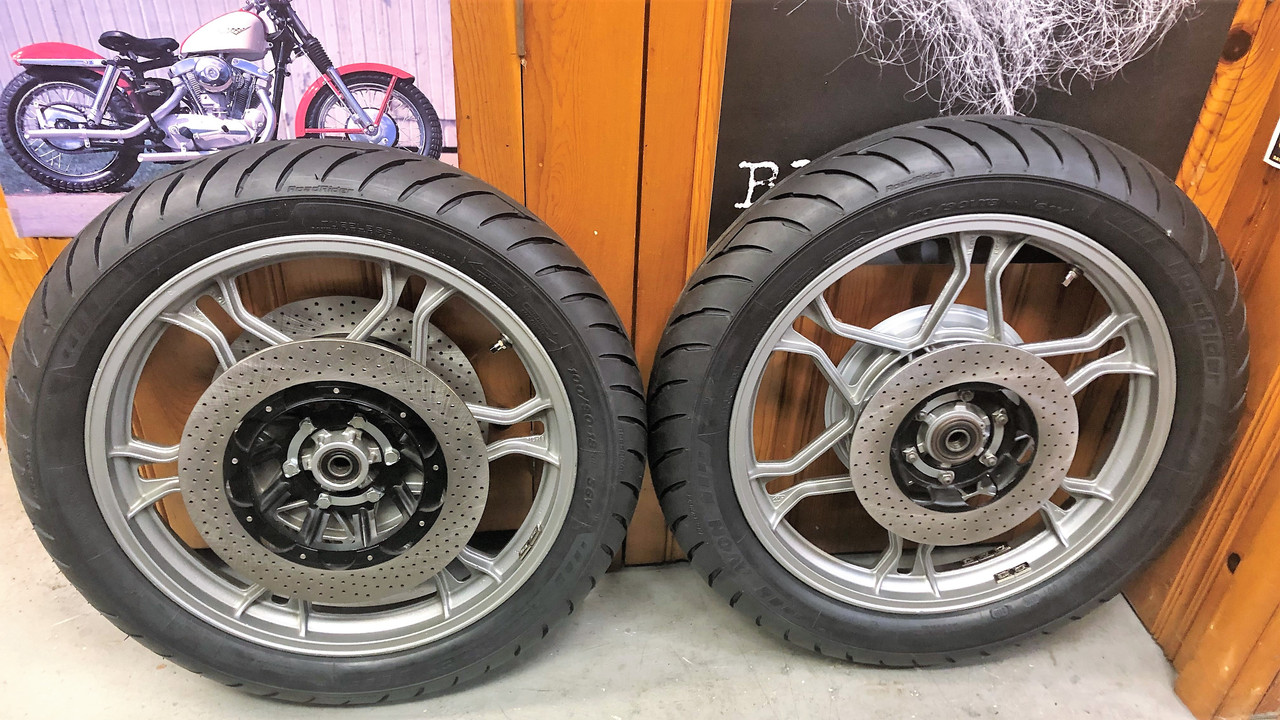

I always love having the wheels done, done.  It feels like the project is really getting somewhere.
New rubber, drive spline and cush rubbers,  disks ground by TrueDisk, and set up for tubeless.

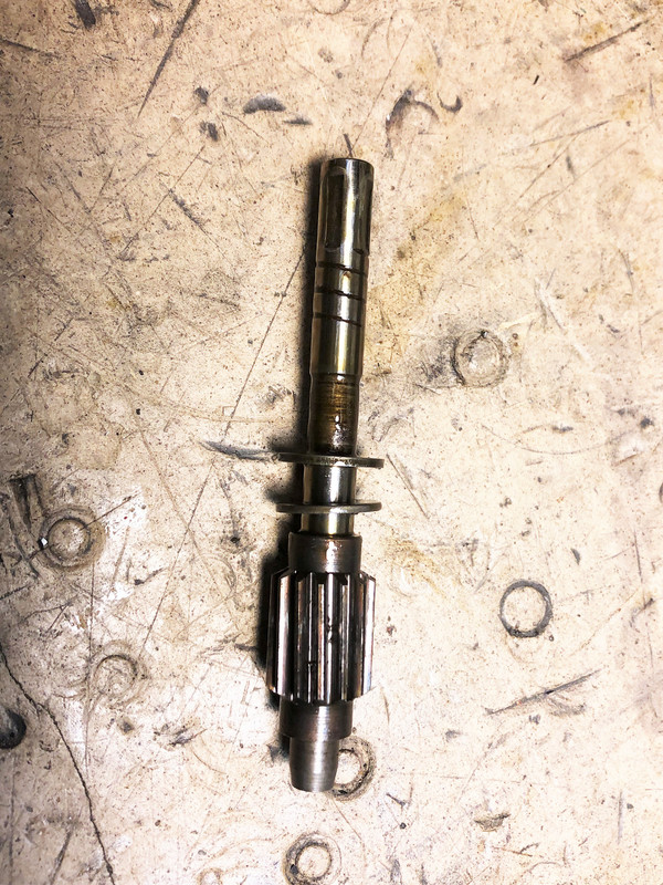

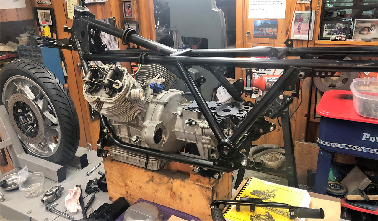

As I teardown the engine for inspection I have had my doubts, thinking that I should just leave it alone.  But since it is out and on the bench I am going to go through it to satisfy my curiosity and to make sure all is right with the world.
I found a problem when removing the tachometer drive.  The tach drive appeared to have only one washer!  The pocket was missing the drive washer.
I checked everywhere for the washer, and then upon looking closely the one washer did look a bit thick!
I am happy I solved the mystery of the "missing" hard washer.  Since this engine was run very little after it was gone through the lower pocket in the outer cover still looks serviceable.

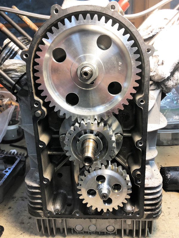

Quite a pleasant surprise was to find this!!  A nice set of aluminum timing gears.

Engine inspection complete.  The rear was seal replaced as a precaution as long as the engine was out.
I also upgraded to a deep spline clutch with the good bonded, and riveted clutch plates.
Going back together.  Next is going through the transmission.

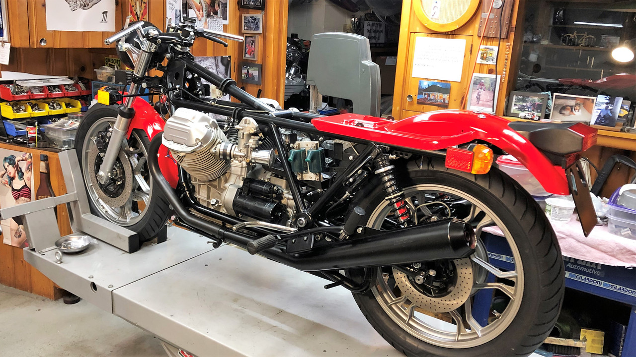

The skeleton is now fully formed.  The carbs look like they mean business!
I know the market heavily favors the 77  Ducati 900 SS over a 77 Lemans but I have always very much preferred the MG Lemans.  To me it has it all over the 900SS in the style department.

  I'm curious about your tires , it appears the tread pattern is in opposite directions on them ?
  Man that is one sweet looking set of wheels  :thumb: .  Peter
  • Posts: 4864
Re: 77 Lemans - Extensive Fettle
« Reply #50 on: September 27, 2020, 04:46:17 PM »
  Lucky you to have a set of Lafraconi mufflers ( they should've been stock) .
The tires are Avon AM 26 Roadriders.  Opposite tread patterns depending on front or rear mounting.

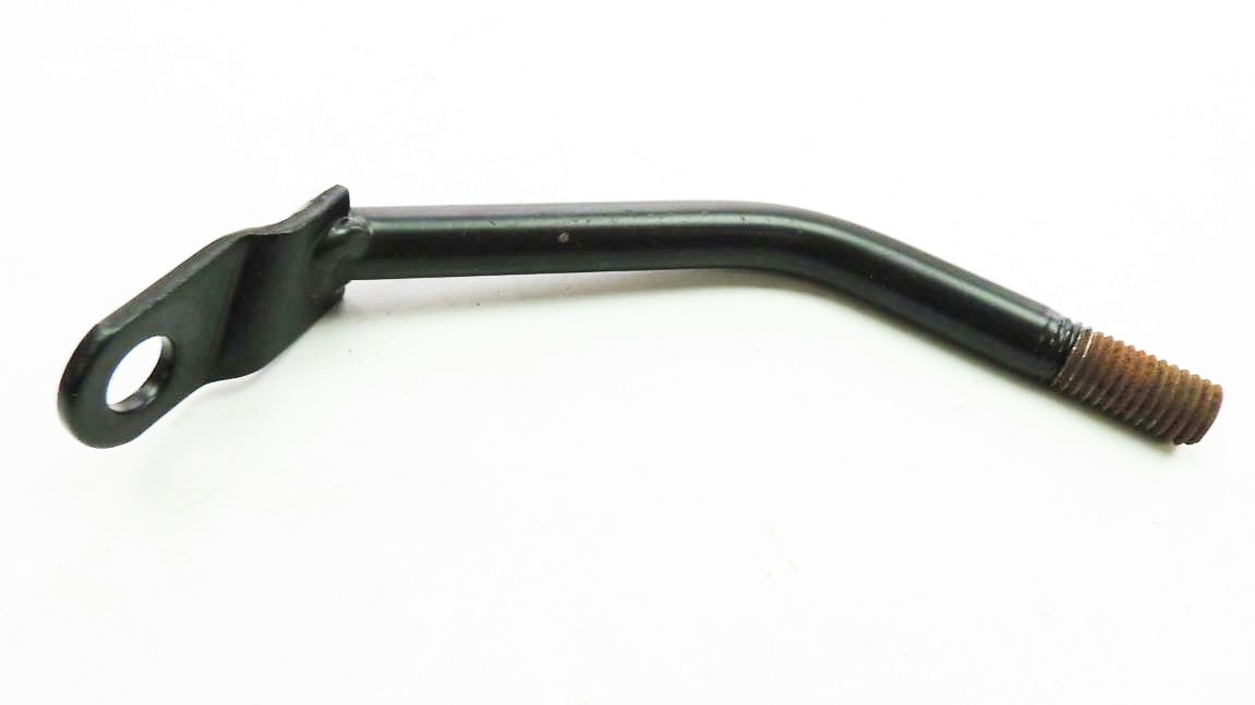

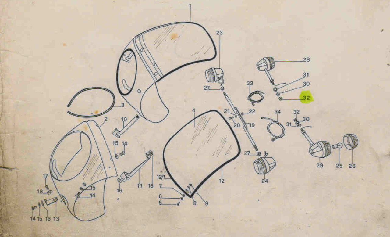

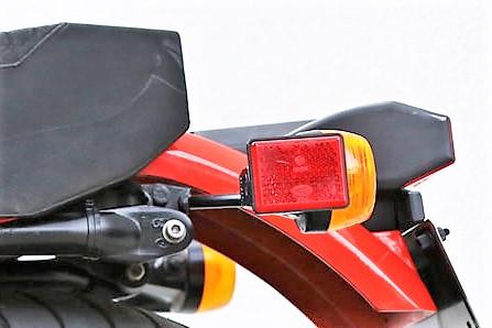

My Lemans had a bit of an oddity it seems.
Every picture I have seen of an early Lemans has the canted rearward rear turn signal stems.   Like this.
My Lemans has the straight stems.
The only pictorial I have found with the straight stems is the early Lemans parts book.
The finish of my stems matches the finish of the frame so I am not going to worry about changing them.  My theory is that the DOT required them to be within a certain distance from the brake light.  Just my house of defecation  theory.   :grin:
« Last Edit: September 27, 2020, 05:40:28 PM by Dave Swanson »

My '79 SP had the canted rearward stems, which broke not long after my purchase. Maybe the same thing happened to your Le Mans at some point and the owner just substituted the straight stems which were likely easier to get and cheaper.

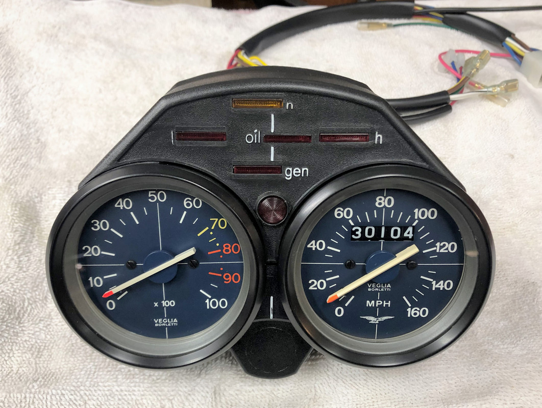

Before.   Both of the plastic housings were broken and unusable.   Instruments banged up.
After Palo Alto refurb, and new plastic housings.
