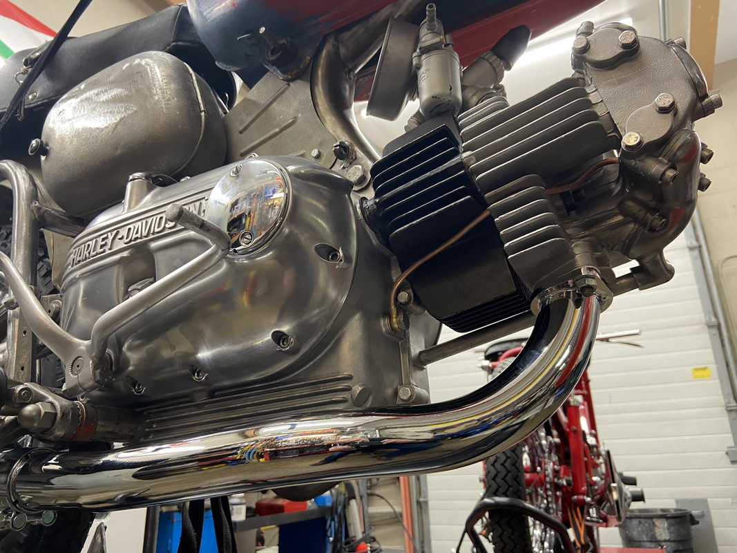

I am building a replica of the early Ala Verde, as lose to stock as possible. Ala Verde parts are very hard to find.
I am starting with a 1966 Harley / Aermacchi  frame and swing arm, this bike had been in a fire and came with no engine and a rear wheel from a 350cc moto cross model. I won't be using the original Sprint gas tank, the big rear wheel or the flat wide seat pan.
I found a H motor for a 1965 a couple years ago and fully rebuilt it, found the correct carb and heel / toe shifter. I am on the hunt for an engine side cover that has 'Aermacchi' cast in the side along with 'Harley Davidson', I saw one a year ago on Ebay and should have bought it then :thewife:

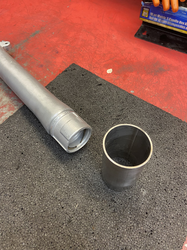

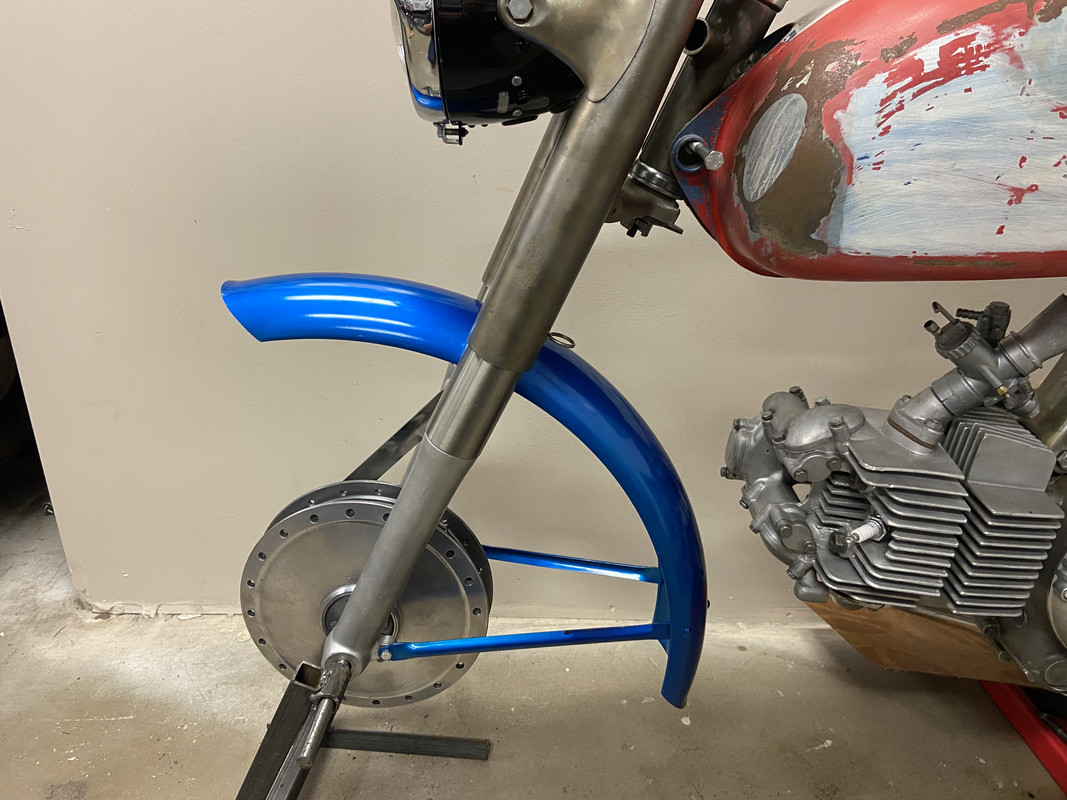

These forks are not correct they are off a post 67' Sprint and are for an 18" front wheel.
These are the correct forks and tripple and are for a 17" wheel,I put them together this afternoon

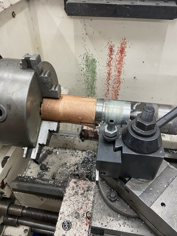

I cut down the 67' forks by 32mm in my lathe and re-cut the lower snap ring into the tubes and bored out the base of the tubes for the damper rod stop. I made new replica chrome lower shrouds from 304 stainless steel thin wall tube,
Trimming the stainless tube over an aluminum slug and a wrap of copper sheet to protect the stainless surface
the stainless slid perectly over the fork lowers and a wee bit of epoxy will permanently secure them once the parts are painted.

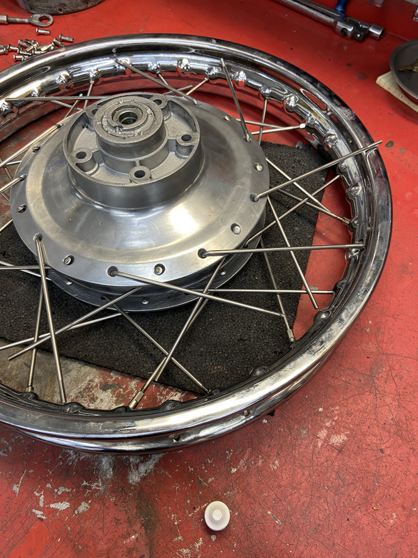

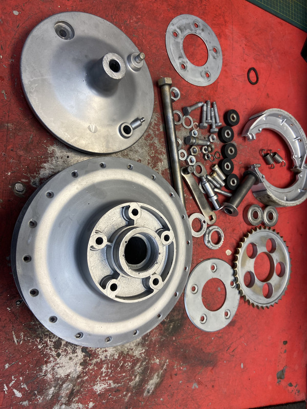

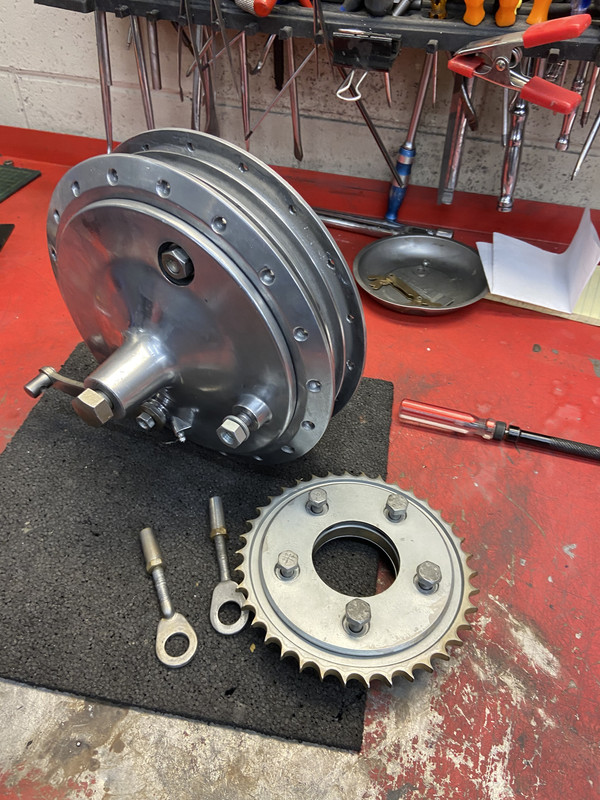

Moto Italia from California came through again for me, a complete rear hub, brake plate and axle for the 1961 Aermacchi 250, for a 17 inch rim, just needs some cleaning up
a half hour of vapour blasting and stripping and more blasting, ready for polishing and then lacing the new spokes to the new rim Moto Italia provided
The threaded bearing retainer was a bugger to get out, lots of heat from the butane torch and using the right pin wrench helps, the nut had been bashed with a chisel in many spots before, I redrilled two holes 180 degrees apart for a snug fit to the pin wrench 4mm studs
pulled the blind bearings

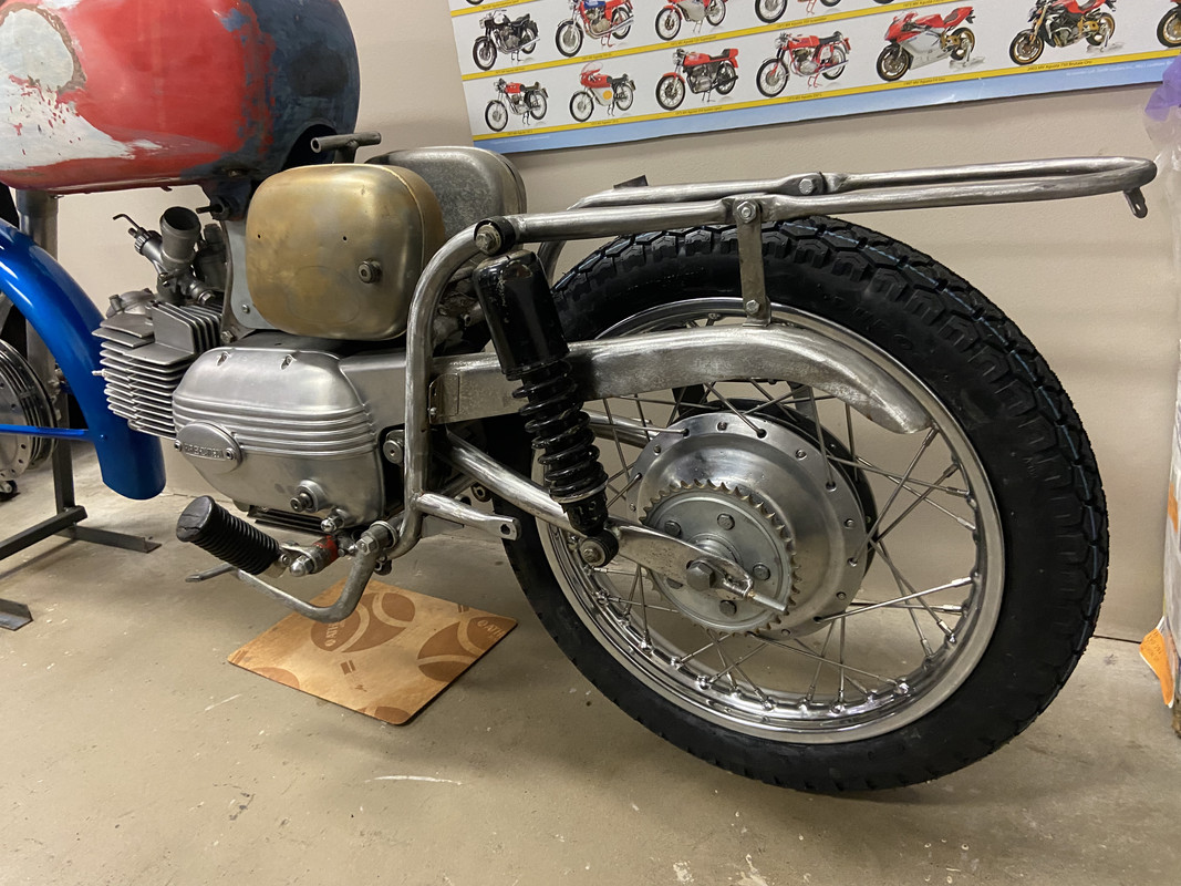

A liitle bit of progress with the Aermacchi, I put a new pair of wheel bearings into the rear hub that Leslie Bull of Moto Italia provided,
Polished up the aluminum hub, deglazed the brake shoes
Moto Italia also provided a new Radelli 17" chrome rim and a set of new stainless steel spokes and nipples from Buchanans
rear wheel all laced up, next to true the wheel and then mount a new tire and tube
I need to call Buchanans and find out if they can make a set of new stainless front wheel spokes from measurements I provide or if I need to send the Honda Black Bomber CB450 front hub and the 17" Radelli rim to them.
Anyone know where I could find a new rear sprocket for this 1961 Aermacchi rear wheel?

I found a Benelli front fender on Ebay that looked like it might fit, I think it will be ok, the top mount has a single tab rather than the double screw tab that wouldbe on the original
Got the rear tire on the new rim, 17 x 3.00, I think it looks ok
I have a couple Harley 250 Sprint rear fenders but none of them fit correctly or look right. I removed the mounting tab on the 62 ~ 66 rear fender I have to try and massage the location of the fender and mount but its not going to work, the 68 on rear fender alos is too big
I think I will look for a Sears 106 SS Gilera fender, my 106 SS rear fender looks like it will be a better fit, the Gilera also has a 17" rear wheel
I screwed up ordering a natching new 17" rim for the front wheel, I was planning on using a Honda CB450 Black Bomber 2 LS front hub but didn't check that it is a 40 spoke hub and I ordered a 36 spoke rim, I might look for the Aermacchi front hub for the 1961 17" wheel
Looks like 17" rims with 40 spoke holes are very hard to find

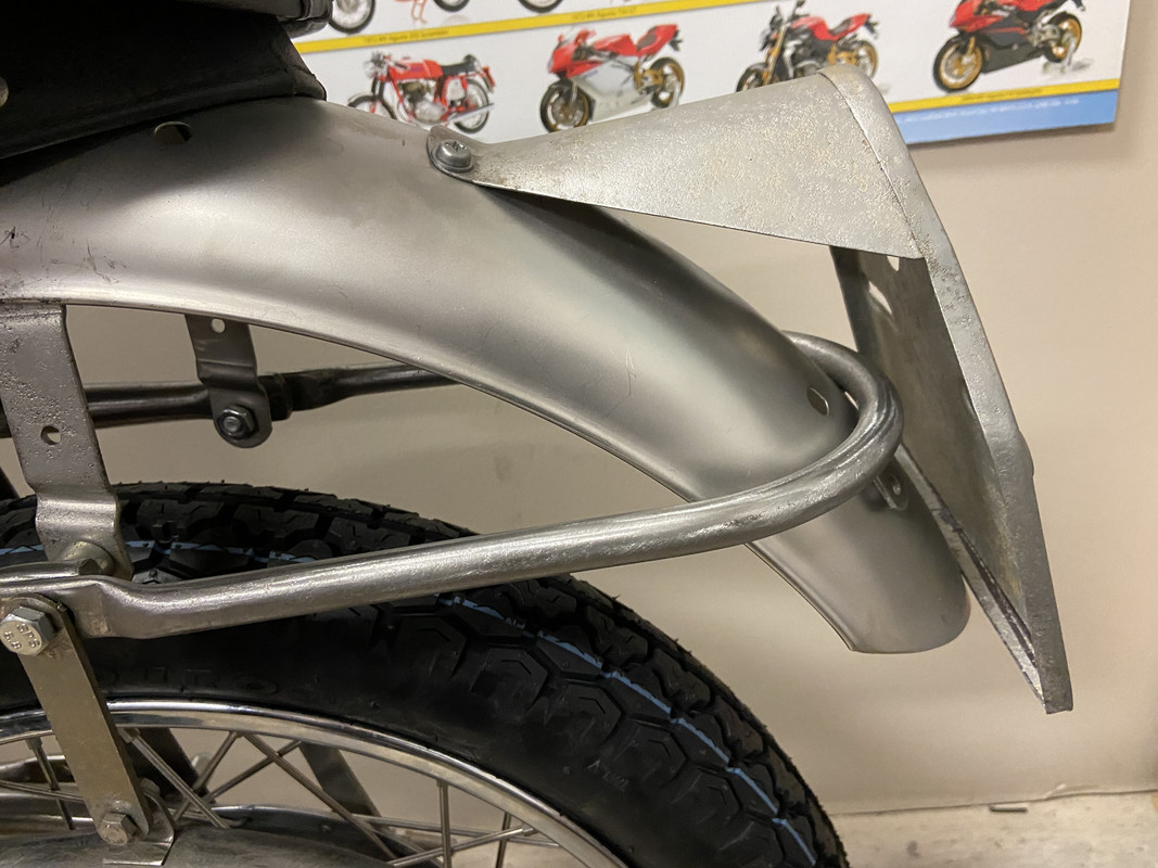

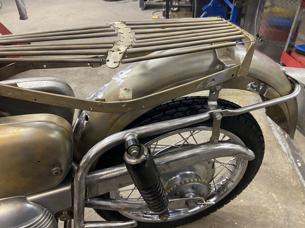

I took the big valenced rear fender I have to a motorcycle bone yard today in search of a smaller diameter fender that looked more like the slim Ala Verde fender. The bike wrecker in town is a disaster, two storeys of mostly 70'e Japanese parts stacked high on wood shelving with hardly any identifying marks and parts just piled on top of one another.
My search did go pretty quick, I found a rear fender, Japanese, probably early 70's by the signal light mount bracket that was bolted to the fender and it appears to be from a bike with a 17" rear wheel, much smaller than the Sprint rear fender. It is free of dents, appears to be stainless and was mine for $50
I think this will work with some fiddling, I need to weld up some holes, drill new holes, weld in some backing plates etc...
I had a rear lamp holder and plate bracket that has the bottom 1/4 rusted off, it is of the style that came on the Ala Verde, I cut off the rusted bottom and foled over a lip, the upper bracket holes actually line up with existong hloes in the fender, perhaps some good Karma?
There are many variations of rear fenders on Ala Verde motorcycles on Google, This is one example that sort of looks like the fender I found
I need to fabricate a bracket for the bottom of the plate holder to bolt it to the fender. The seat cover is sitting over top of a smaller Aermacchi seat, I am waiting on a used seat frame for an Ala Verde to come from Italy.
I am pretty happy with how its coming together

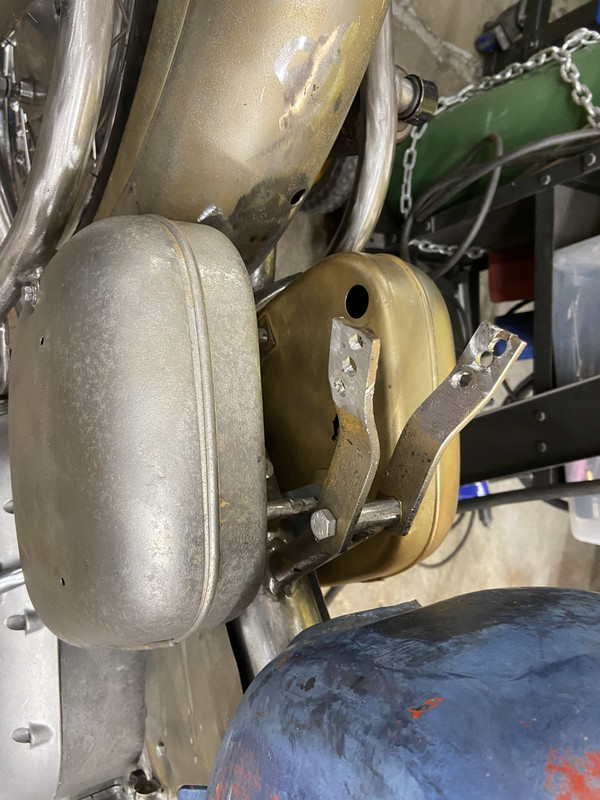

I was still not happy with the rear fender I found, the Ala Verde has a rear fender with shallow skirts set into sheet metal folds of the main fender body, and it has to be suitable for a 17" rear wheel.
I took a look at the rear fender on my Sears Gilera 106 SS, another Italian motorcycle with17" wheels and thought maybe it could be made to fit. I was lucky to find a very cheap Gilera 106 SS rear fender on Ebay, it was split at the rear and twisted buit salvageable. I welded up the original mount holes in the Gilera fender and removed a rear fender bracket from another later model Aermacchi Sprint fender and went to work with the hammer, dolly and welder.
The brackets fitted

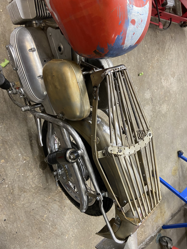

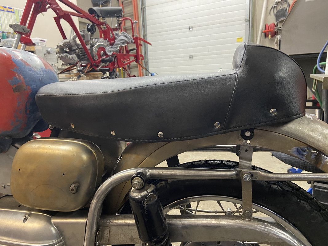

I was also very fortunate to find an original Ala Verde seat frame (year unkown) on Italian Ebay, I blasted it clean and then I removed the rear seat bracket to position it over the center of the rear fender main support
I need to remove the front seat brackets and reposition them as well to align with the Sprint frame seat support, should be an easy job
I found a reproduction Ala Verde hump back seat cover in Italy, it fits great, seat cover loosley fitted for alignment

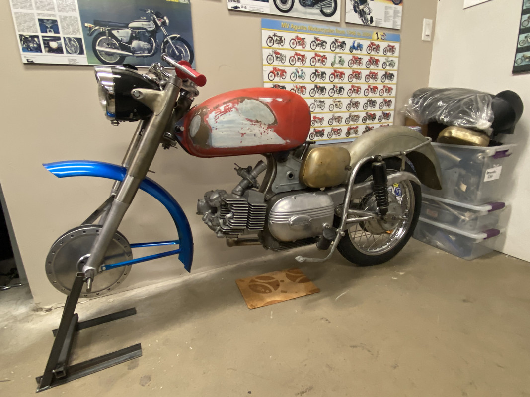

Ebay turned up a correct 1961 Sprint front fender that I will use (the blue fender I have on the bike is from a Benelli) and Moto Italia sent me a complete front hub and axle for the 17" front wheel,
The Honda Black Bomber front hub is now surplus, if anyone needs it let me know, willing to let it go for cheap with a pair of new shoes.
Getting closer to sourcing all the hard to find bits. I need to modify the front fork shrouds to expose the top of the fork tubes and fit the original type clip ons. I would alos like to find an emgine case side cover with "Aermacchi / Harley Davidson" cast into the alloy, this would be correct for the Ala Verde circa 1961, if anyone knows where I can find one please send me a pm.

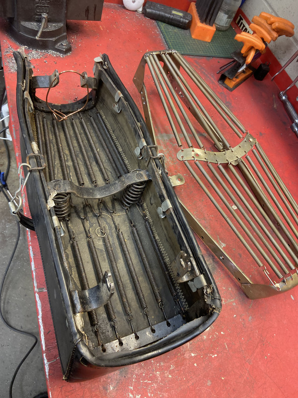

I took a closer look at the seat before rewelding the support brackets into position, the years of use had resulted in the hard spring steel cuting the mild steel frame,I  rewelded up the frame at the spring mount locations
Two of the horizontal springs were missing, there are four different lengths of springs and the two coil vertical main support springs are missing as well. I had a spare sprung seat that came with another project that is surplus so I removed the missing springs I needed from the spare
All the springs fitted, and the front support brackets were removed from the seat frame by drilling out the spot welds, reshaping the brackets and then cutting down the width of the bike frame seat mount to fit the Ala Verde seat
I used four vice grips and a spirit level on the bike frame and a level on the seat top to level the seat brackets mounted on the bike prior to welding the whole seat back together
I can’t rotate the image but this is the final fixing of the seat, now to paint the frame and then permanently mount the new seat cover
« Last Edit: November 25, 2021, 06:39:01 PM by Canuck750 »

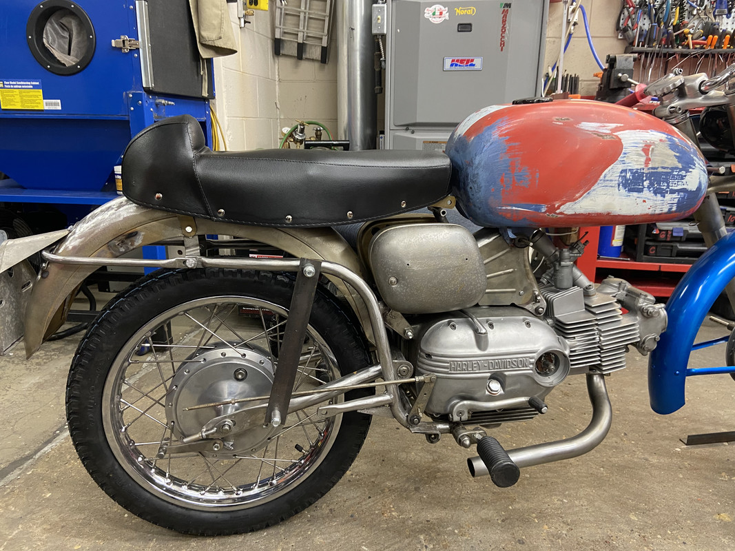

I powder coated the seat frame today, my shop oven is just big enough to take the frame, black powder about to be cured
I fitted the seat, I had to remove the cover and trim down the center upper spring bar and move the outer springs in about 8mm to get a proper fit, it is not perfect, I don't think the frame was actually for an Ala Verde but its close enough
Upon remounting the seat to the chassis I found the rear hump is too tight to the rear fender, I extended the rear center mount bolt, fitted a spacer and then redrilled the seat side lugs to the fender bracket, a couple more holes will need to be welded up in the fender.
I got a 1961 Sprint front hub from Moto Italia, the hub outer surface had some deep nicks and corrosion
I mounted the hub in my lathe and starting with 100 grit dry I spun the hub and used a foam rubber backer with the sandpaper to sand out the nicks, it took about a half hour on the lathe working up to 220, 400 and then 1000 grit wet
I finished off with the bench polisher
Reassembled the brake plate and test fitted the hub and installed the 1961 Sprint front fender
It is starting to look a little more like an Ala Verde

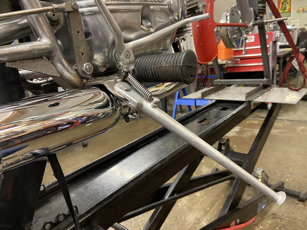

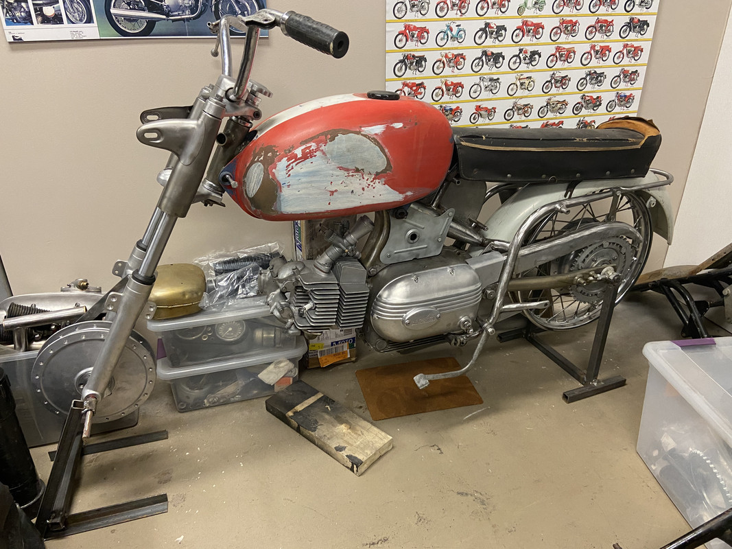

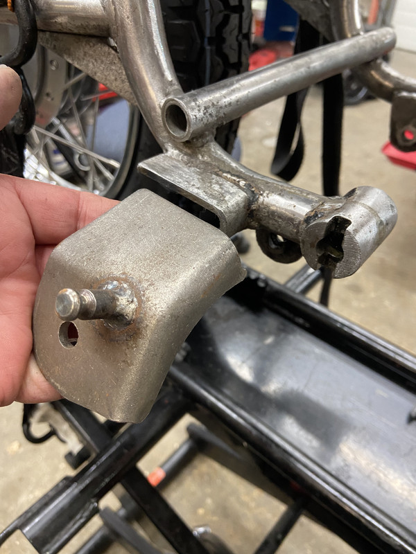

A little progress towards getting the Aermacchi to rest on two wheels, it will need a stand, the original stand bracket was partialy cut off the frame I started with, Harley Davidson offerd the side stand bracket as a separate option to weld to the frame, found this one on Ebay
Zipped the remainder of the old stand off and welded n the new bracket
I removed the mock-up motor to weld the bracket and swapped in the 250cc Sprint engine I had rebuilt a couple years ago
I fitted the repro header and muffler and the heel toe shifter I found on Italan Ebay
side stand and brake linkage cleaned up
I dropped the front wheel I laced up on Saturday, getting a new tire and tube installed and then the little Green QWing can be rolled into a corner
Re: Little Green Wing - Aermacchi Ala Verde
« Reply #24 on: December 24, 2021, 03:09:43 PM »
On two wheels (and a side stand), the little Green Wing moves to the backburner now to make way for other projects

 I will keep doing small things and adding parts to the Aermacchi to the point of getting it running then disassemble for cosmetic work down the road. I want to finish the Airone before I get into the full deal on the Aermacchi or Benelli, and that oil consumption issue with my Ducati 860 has me occupied right now.
