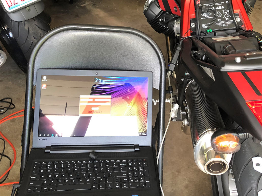

ps , I see on the picture you didn't connect your bike battery to the charger while connecting to ecu?
should I first test guzzidiag program to see if it connects ok, before reading/wrinting ecu?

  • Posts: 4720
Re: V85TT ecu remapping
« Reply #14 on: July 21, 2024, 08:59:32 AM »
@Dave,
Thanks, I thought so but was a little in doubt after reading some posts at the guzzitechforum ( I think he only want to sell his own products , and therefore bashes other people who see it more like a hobby)
kind regards,
Jack
The leads are connected.  Take a closer look.  And you have figured out what is going on over there.   :cool:

I would add pics of the guzzigiag showing the codes and the exhaust for sensor placement and bluing comparison. Imgbb is not playing nice tonight.
Thanks for reading,
Jay Storm
