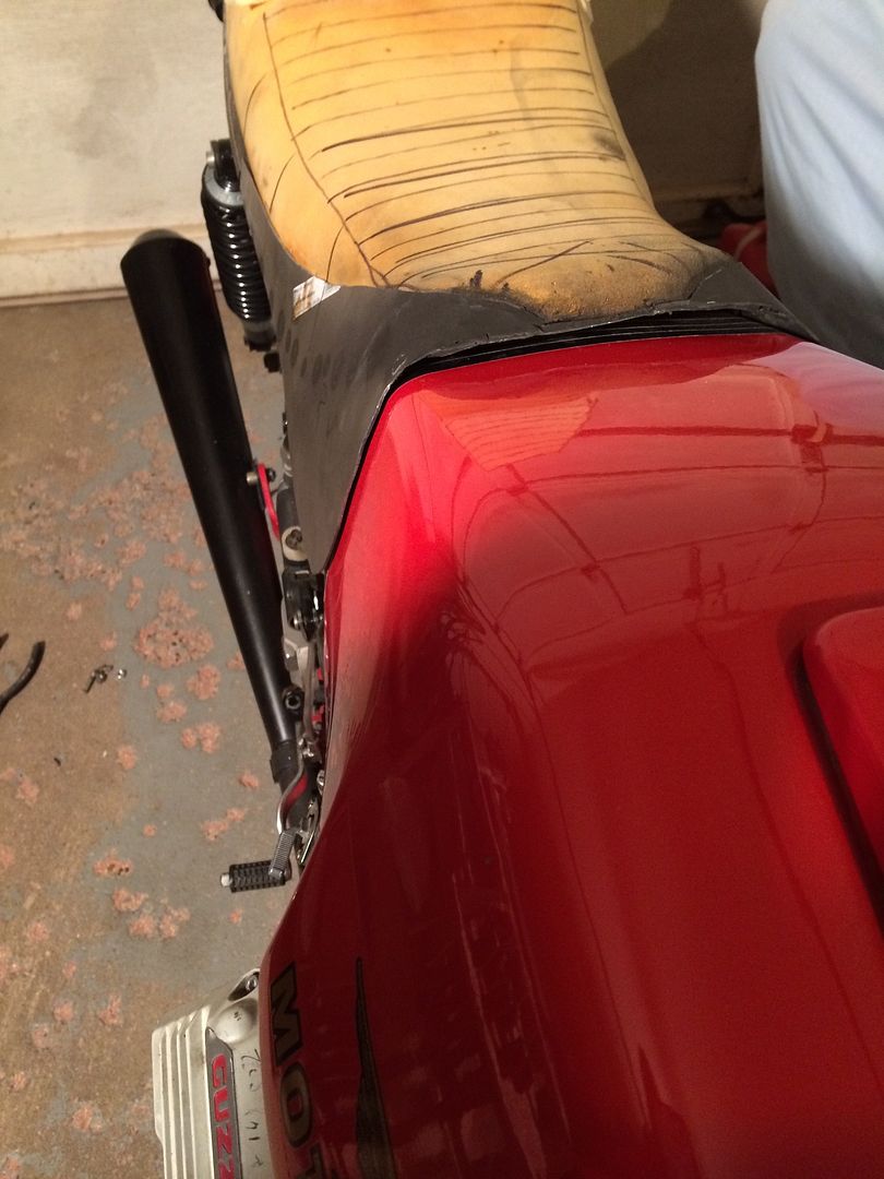

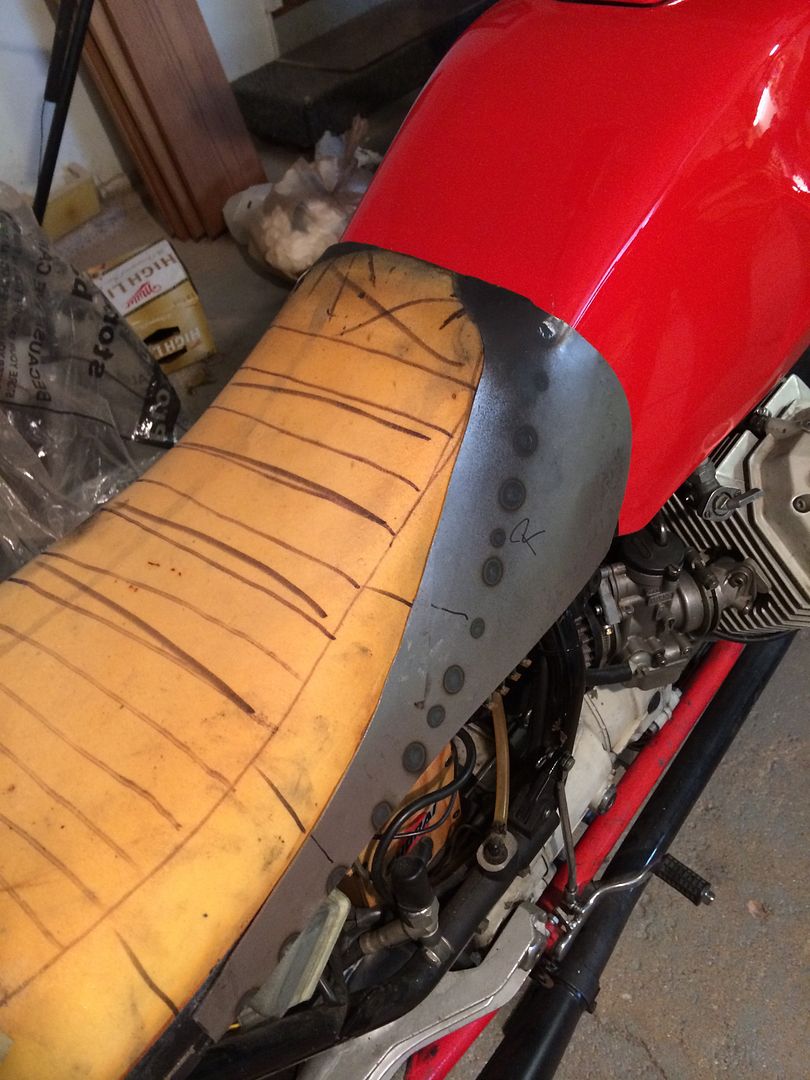

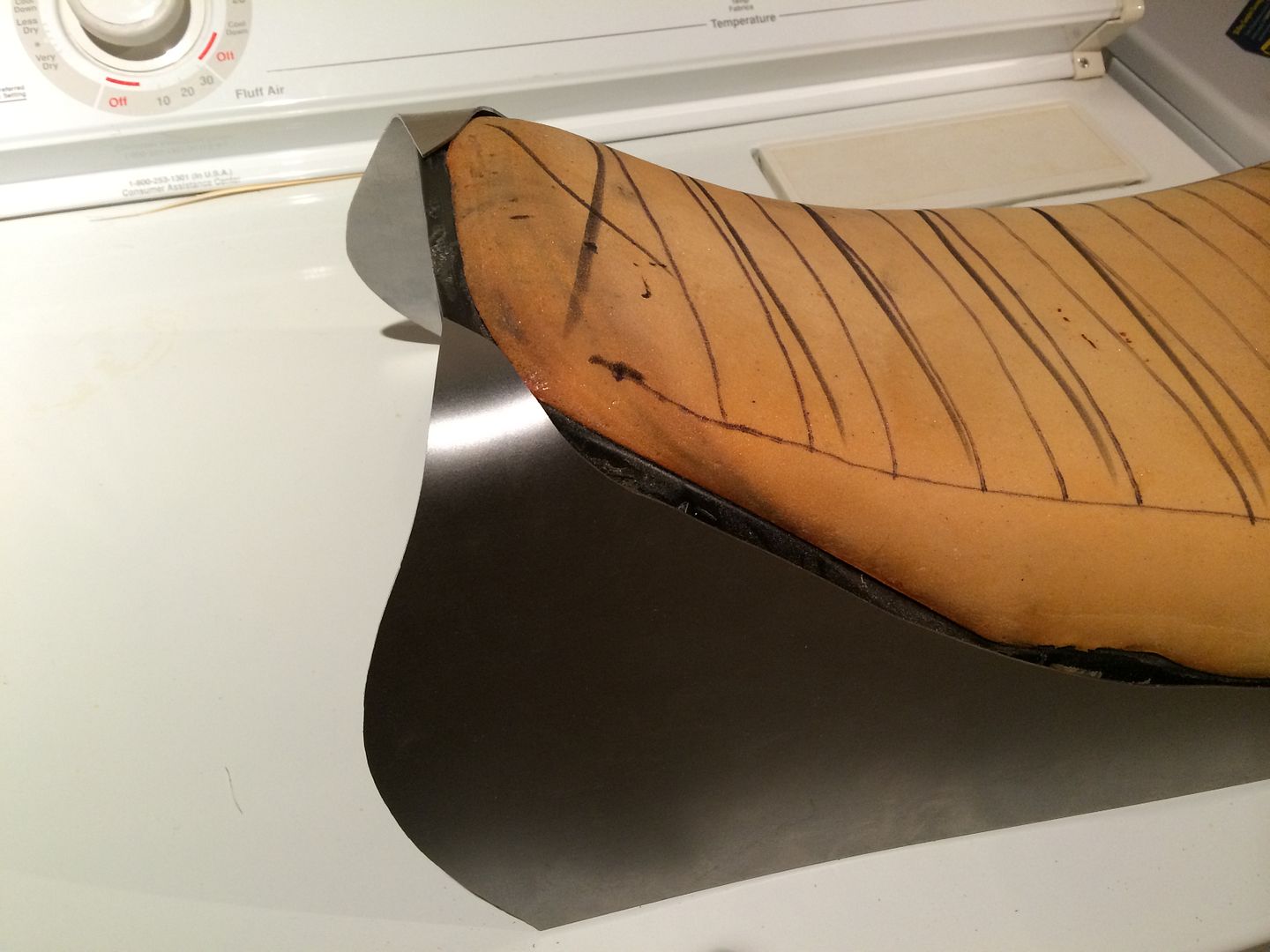

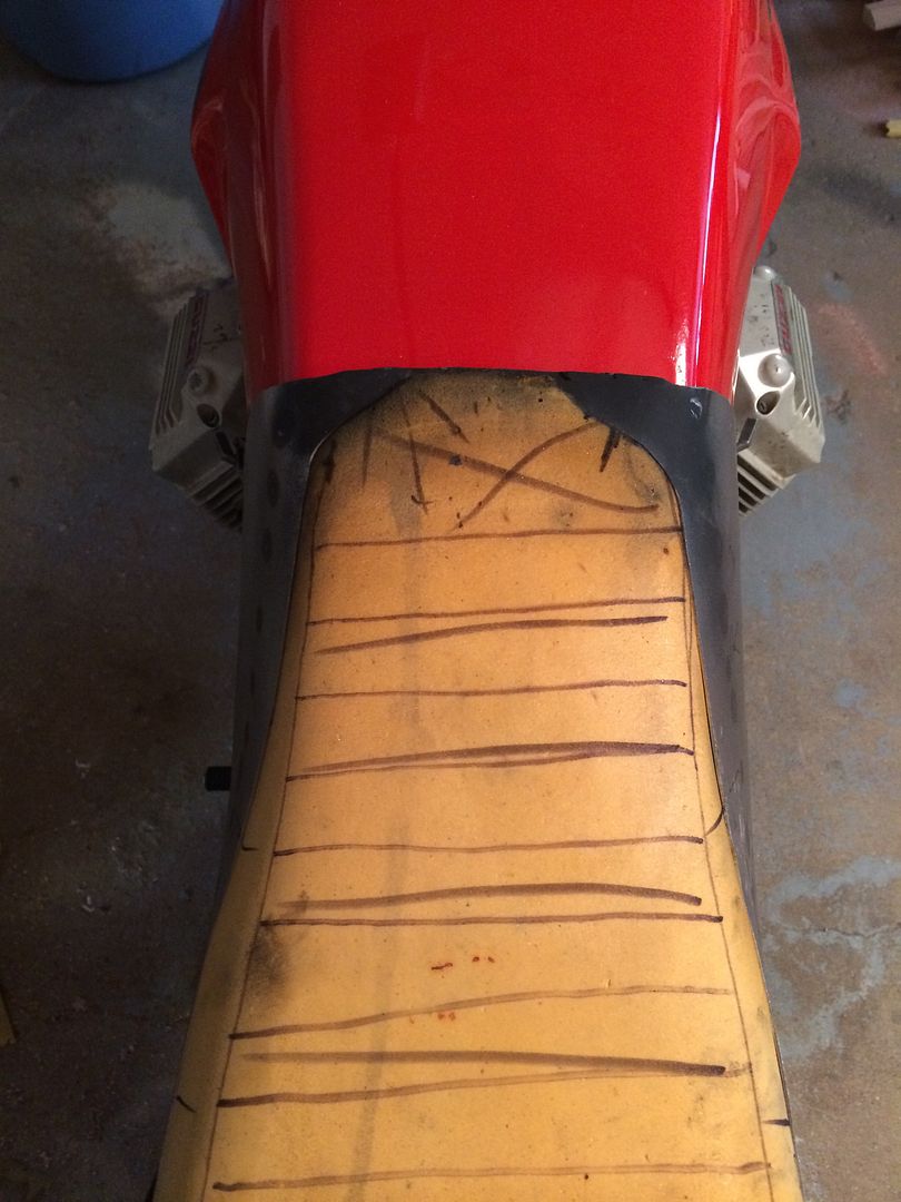

Seat project started today. Cut the sheet metal and will take this to my seat upholsterer for welding, etc.  More soon.

Figured out the under-seat arrangement. A little over/under of the original bits and it's finished. Level and solid. Tomorrow I get the seat back to do some fitting.

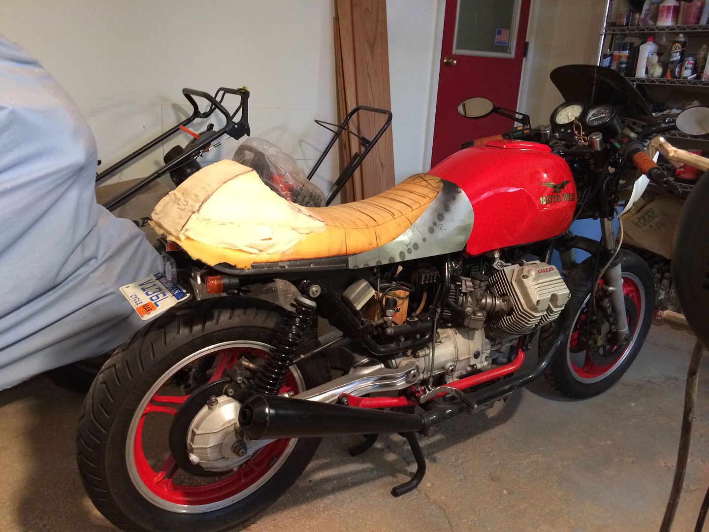

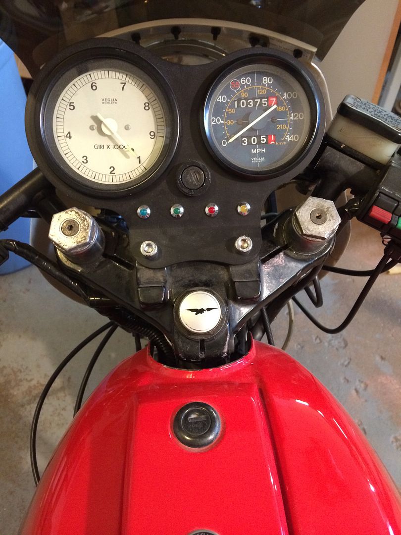

Seat tacked and bent to final shape. Time to bring it back for upholstery (pic thrown in). Threw in a little piece of bling from MG on the steering head.

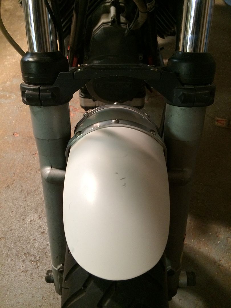

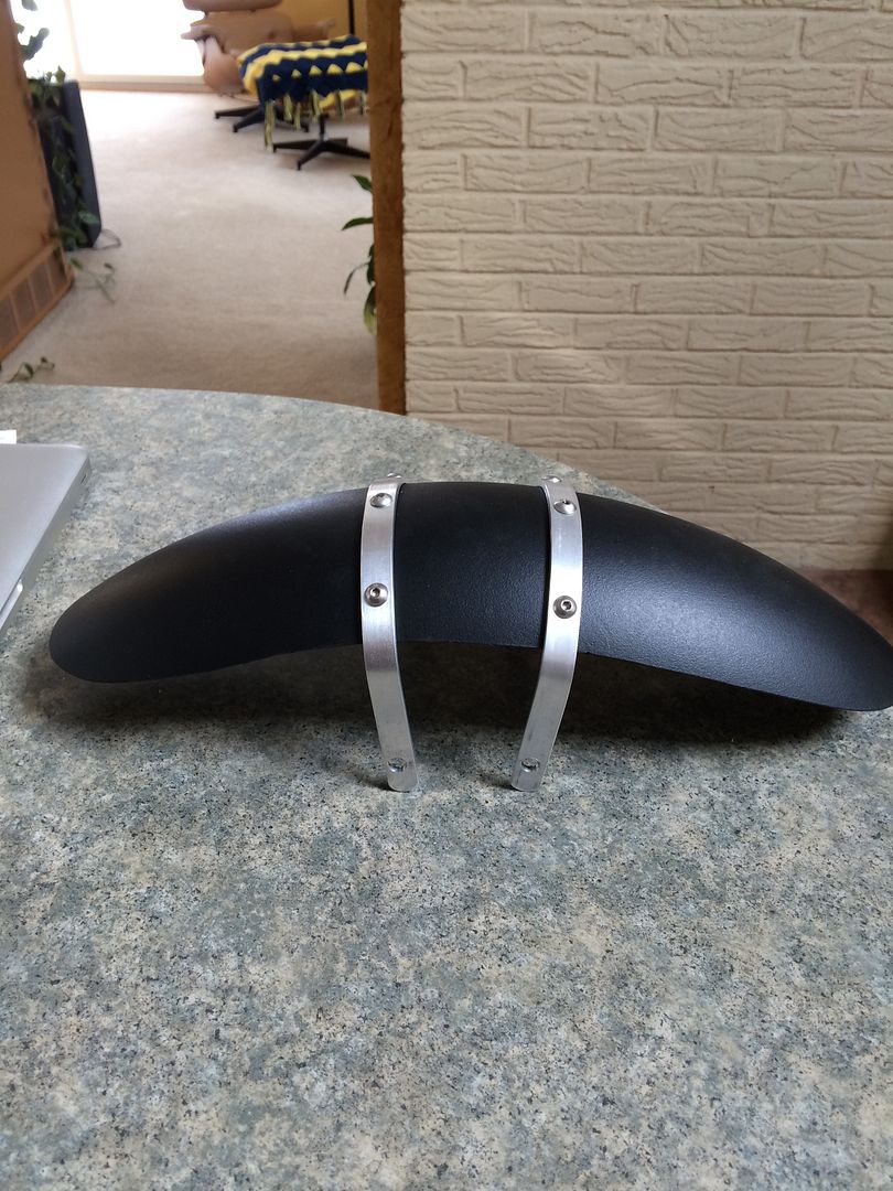

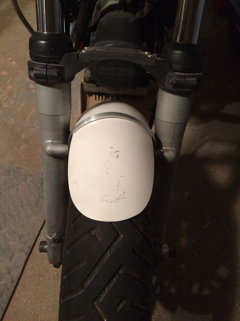

Since I'm waiting for my seat I figured I should get after the fender and mounts. Did some playing and decided on a wrap mount. There will be a rear one also.

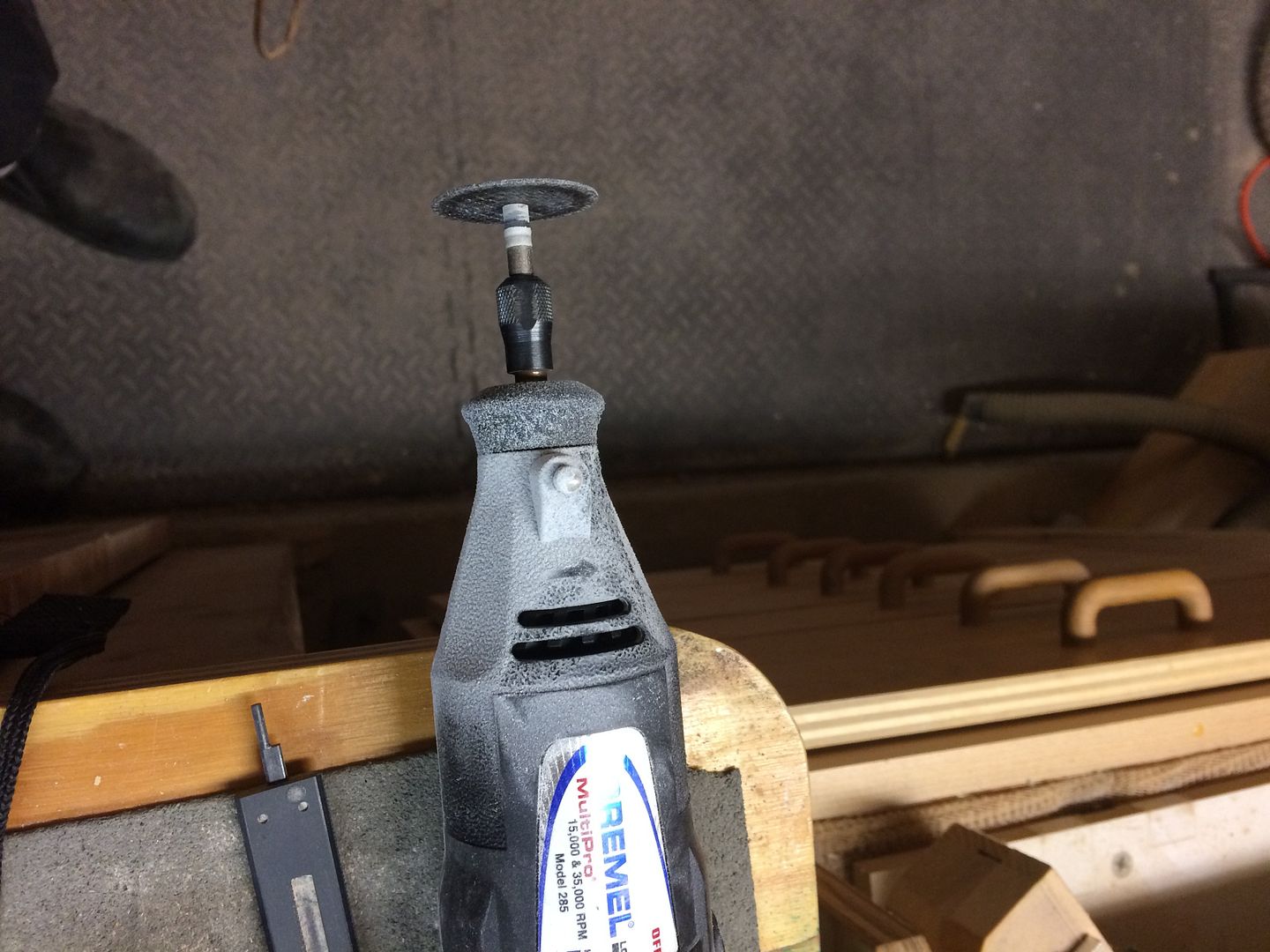

I use this respirator from the wood shop for cutting this fiberglass. I also prefer to use this thin cutter as it creates very little dust. It also cuts very precisely.  Make the line and take a few passes to cut through. Use sandpaper to even it out.
« Last Edit: February 01, 2015, 10:21:20 PM by kevdog3019 »

What was the starting point for your fender Kev? That's no Lario stocker.. Is it a generic blank or.,...
Offline kevdog3019
  • Posts: 5648
Re: "Super" Lario build started
« Reply #127 on: February 01, 2015, 10:27:14 PM »
It's Airtech stuff; both the fender and LM1 fairing.  Fender has been slimmed down a lot.  Will cut the back off after I decide exactly where I want it.  It's easy stuff to work with.  You just want to make sure you start with a fender that has the right radius to fit the wheel.  This one was perfect.
BTW... the stocker doesn't fit the Marzocchi's hence the re-make.
« Last Edit: February 01, 2015, 10:30:06 PM by kevdog3019 »

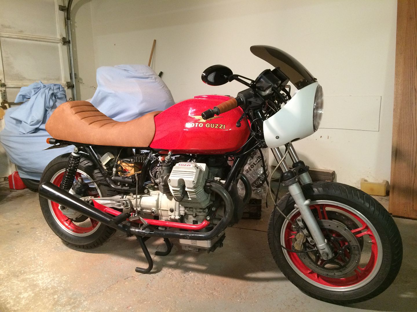

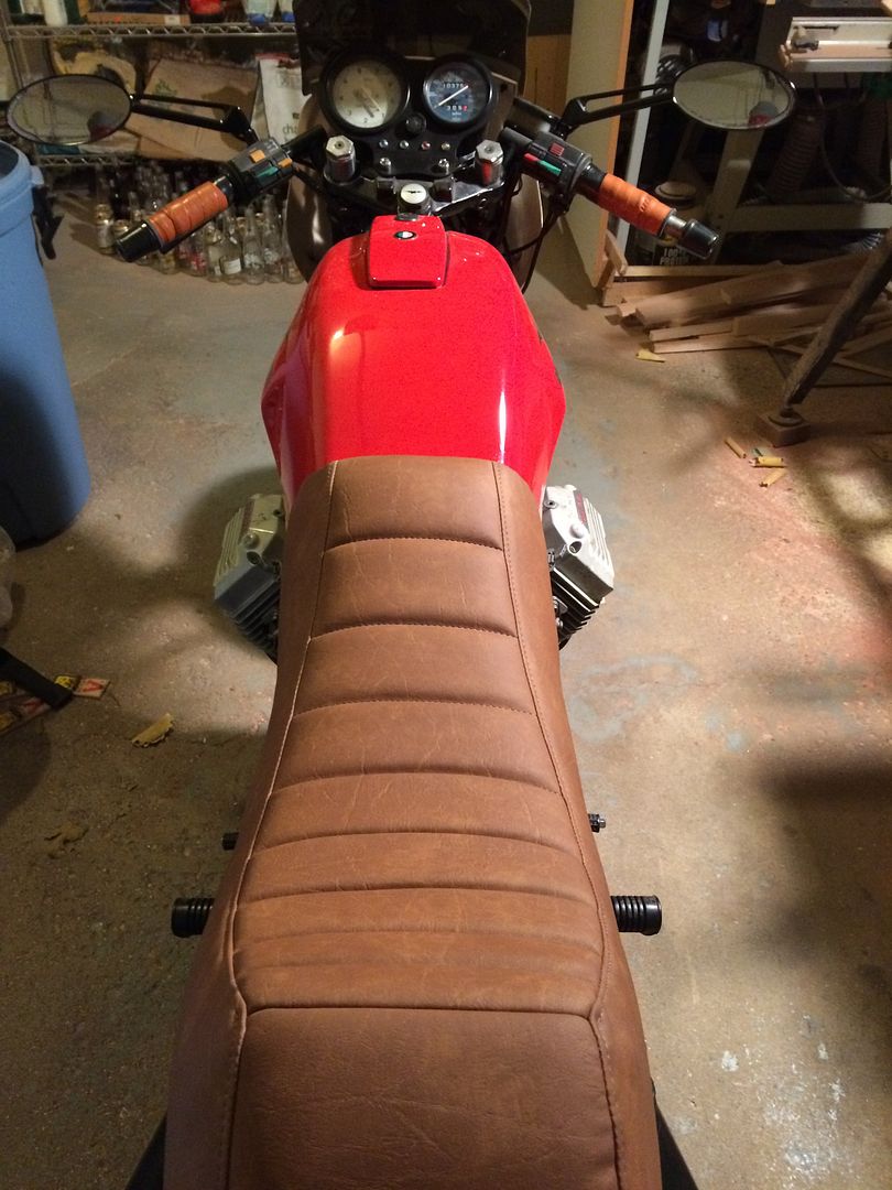

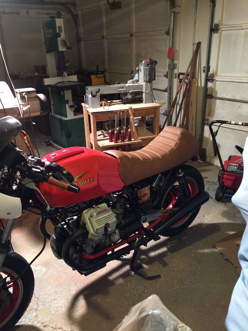

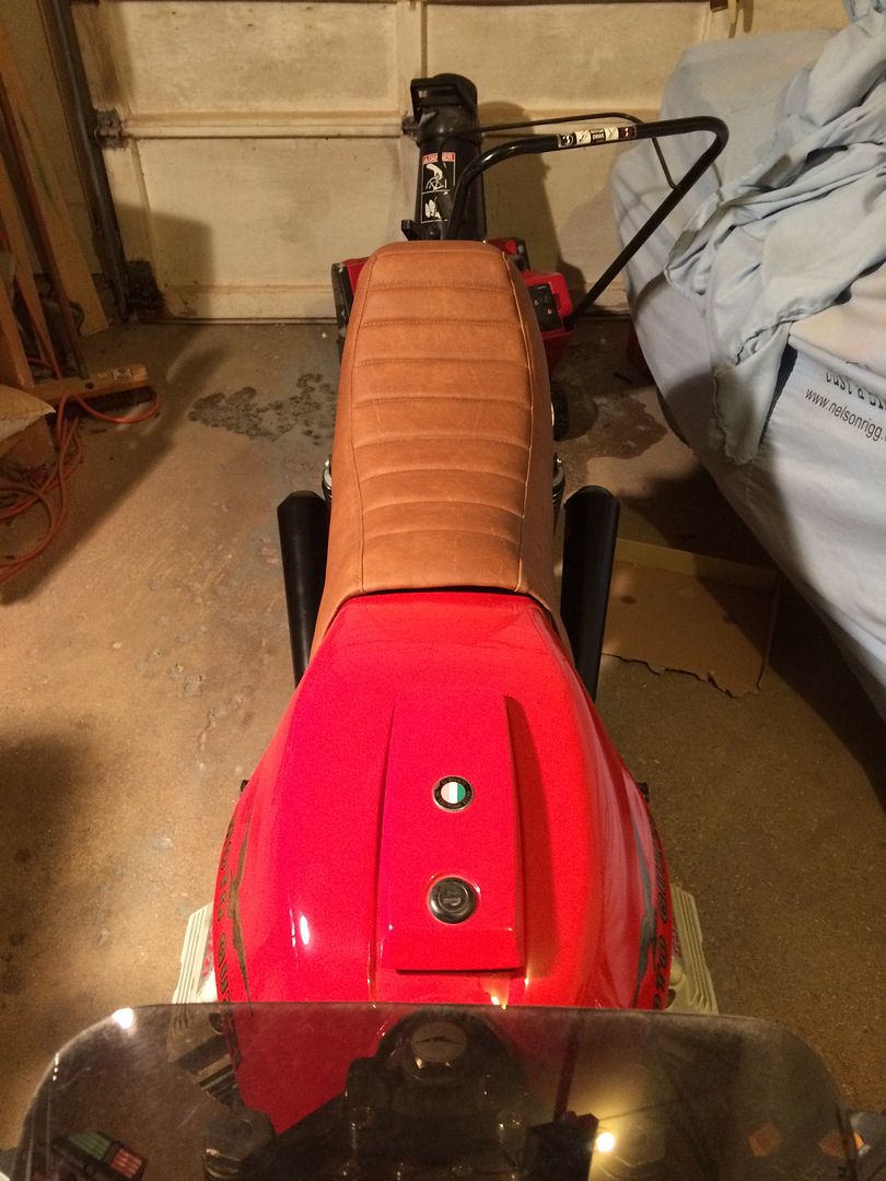

The seat is home and fits splendid. It's hard to tell, but it's a stressed tan that looks great in person. This was done locally at Mark's Upholstery in Jenison, MI..  He's a wonderful guy to work with. You'll see that he strobes the cross-stitching by going larger to smaller. I like it myself as it gives some depth and isn't perfectly uniform.

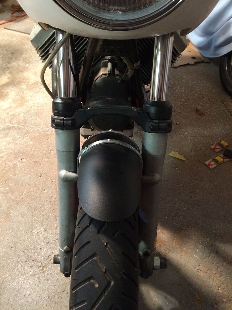

Fender mounted. Thanks Chuck for the clearance specs. Around 20mm as I feel that's safe. Lots of work to get things just right. She's solid!!

Looks great with the brown seat, the flush headlight in that LM1 fairing, and the custom cut fender :thumb

Hopefully, the nuts on the fender don't compromise the clearance too much?
Offline kevdog3019
  • Posts: 5648
Re: "Super" Lario/LM1 SB clone build
« Reply #142 on: February 08, 2015, 08:09:18 AM »
Yeah, that was all in the figures. There's plenty of room for something that might get picked up. There's also nothing sharp as the nut is a perfect fit to the end of the screw w/lock washer.

Nice job of forming the fender mounts..
Offline kevdog3019
  • Posts: 5648
« Reply #144 on: February 08, 2015, 08:31:48 AM »
Lots of thumb work on that as well as vice with hardwood inserts for the tight bends. I got some experience with aluminum bending on my LM fairing. I braced the entire horizontal length where the windscreen screws into the fiberglass. There's a perfect groove to fit a bar along that space. I did this so that I could make runs up to it for bracing w/o compromising the fiberglass. The windscreen puts pressure enough on it. I realized in bending that how easy aluminum is to form if you take it slow. Once you kink an area you're pretty much through.

Here's the question now; do I paint it black to (essentially) disappear, or red along with the fairing for tire jewelry?  Red would give s but more "classic" look but not sure I'm after that much "class". I need input!
Thanks
Edit: I won't have a tail fender, just s tail "tidy". Maybe this makes sense to go black?

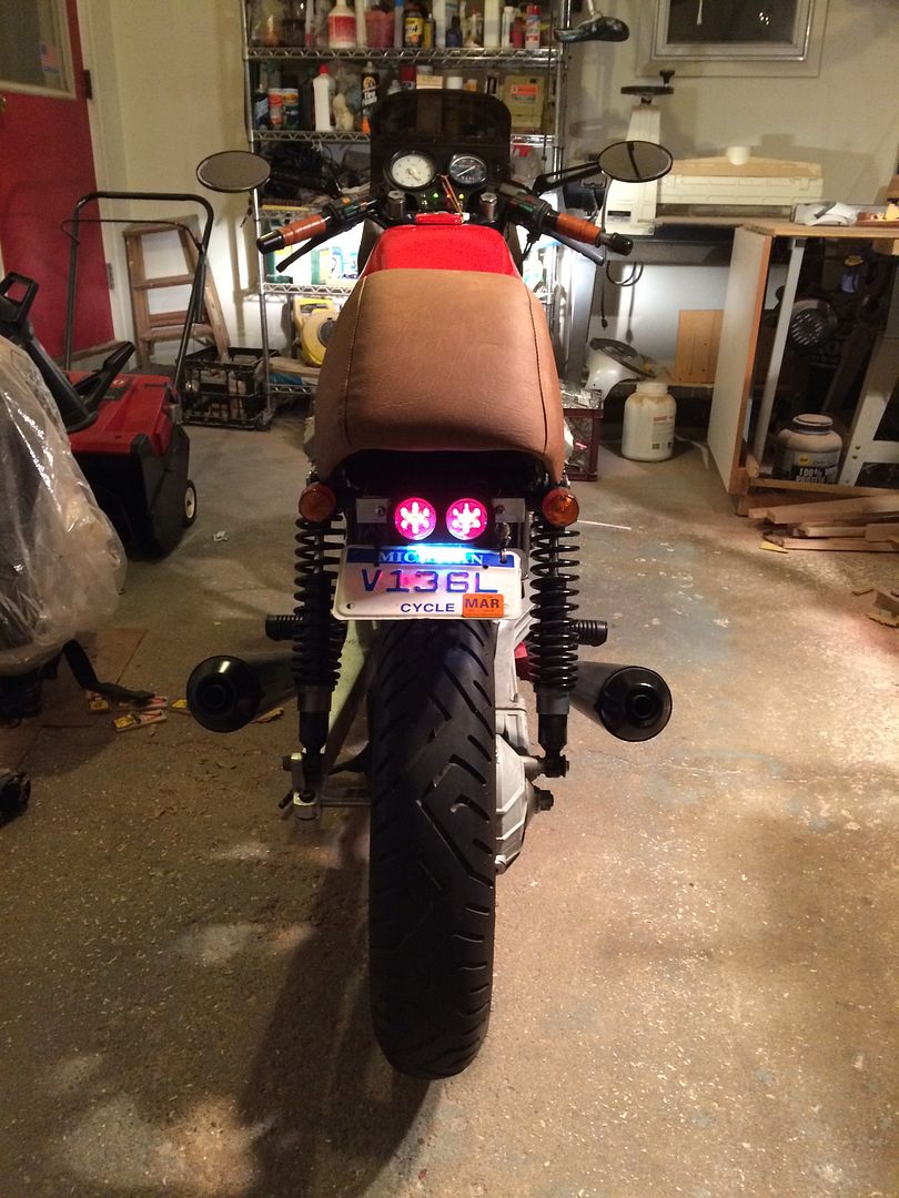

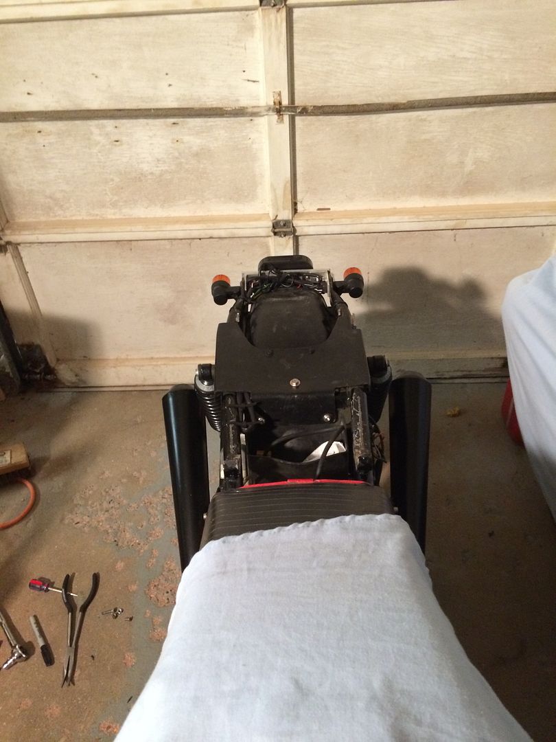

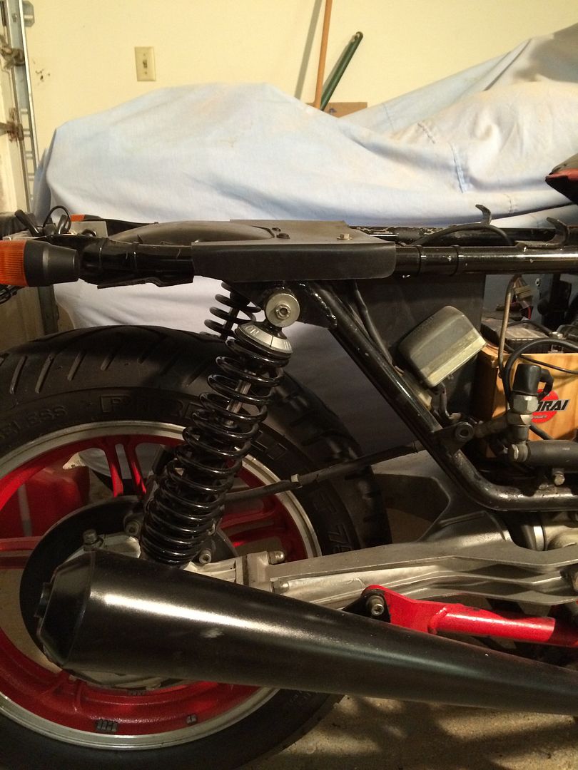

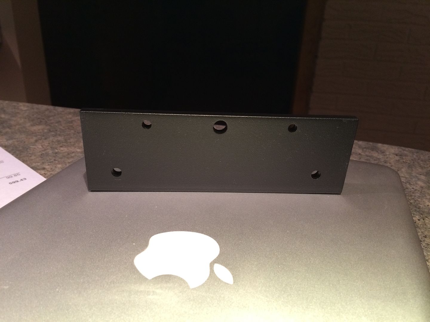

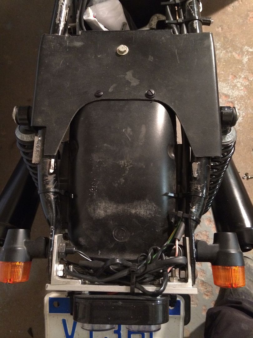

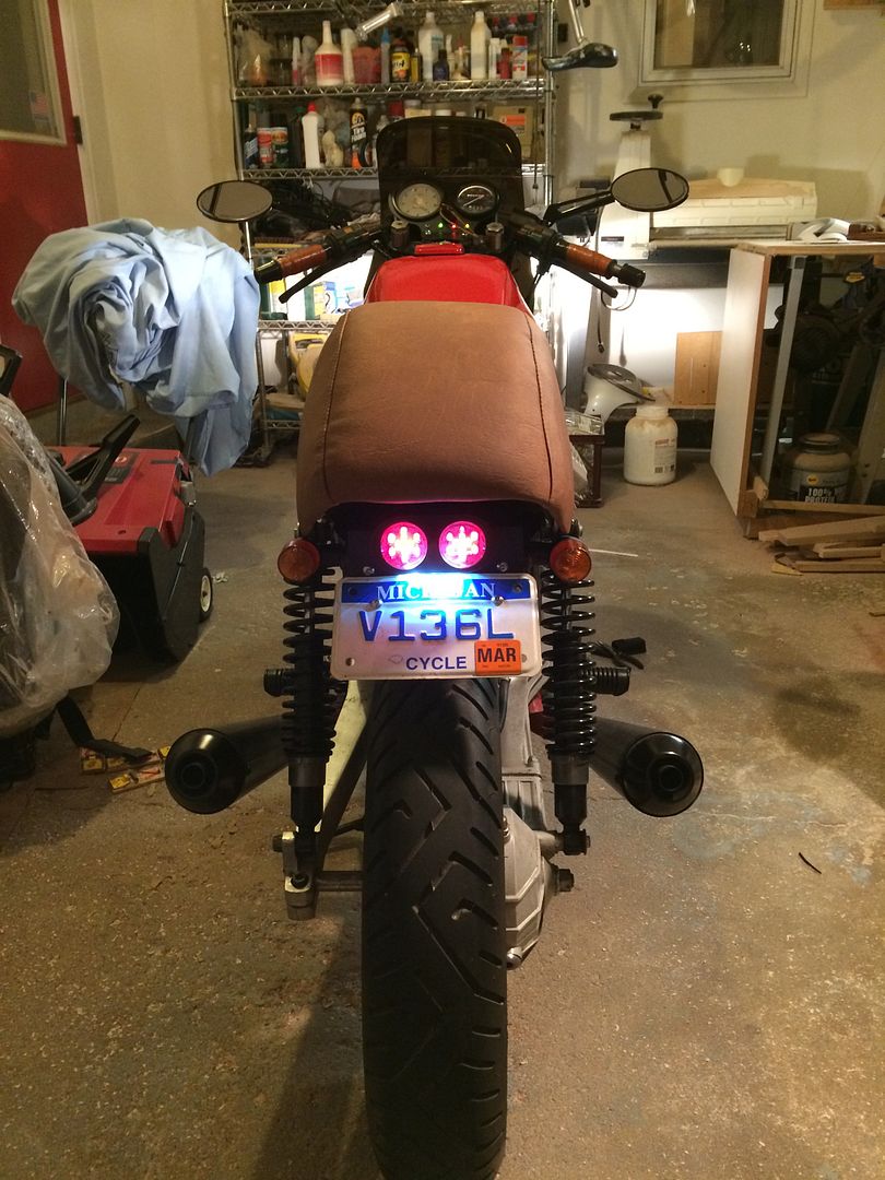

Did some adjusting of the taillights now that the seat is finished. Raised over an inch up under the seat.
Fab'd a mount and painted it:
Before:
After:

Raising that plate looks a LOT better.  Funny how a small change can make a dramatic difference in appearance.

Alright, got her done. Fender now in black. Another check off the to-do list. Nondescript yet dressy.

Oh yeah!  You are getting the baby LM look going now!  Sweet ride!
