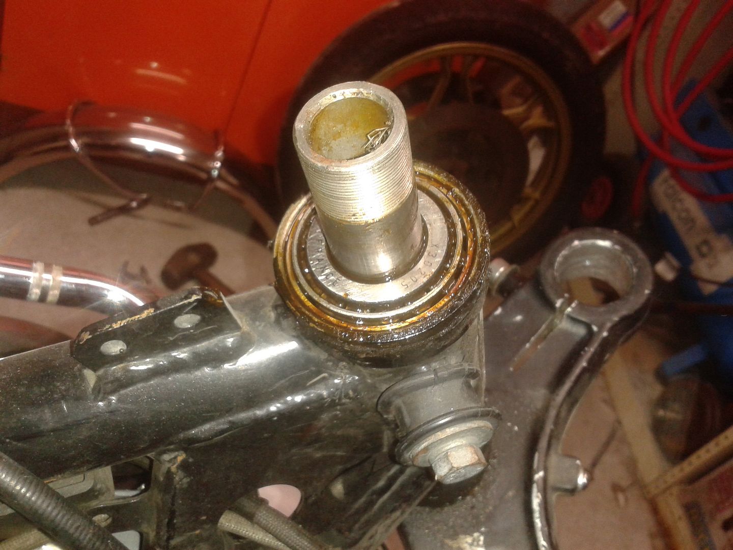

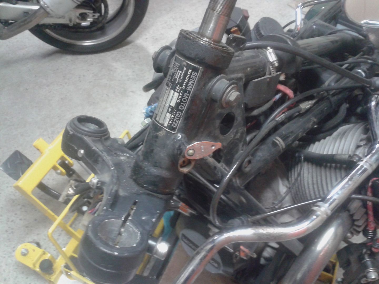

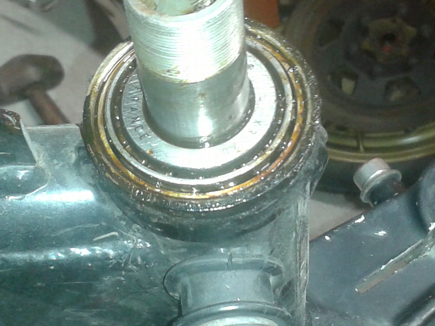

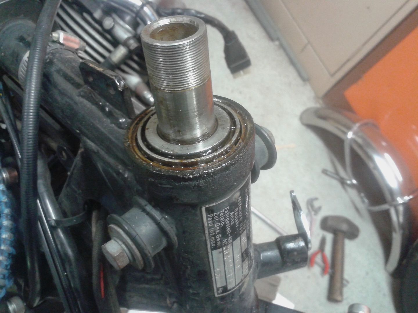

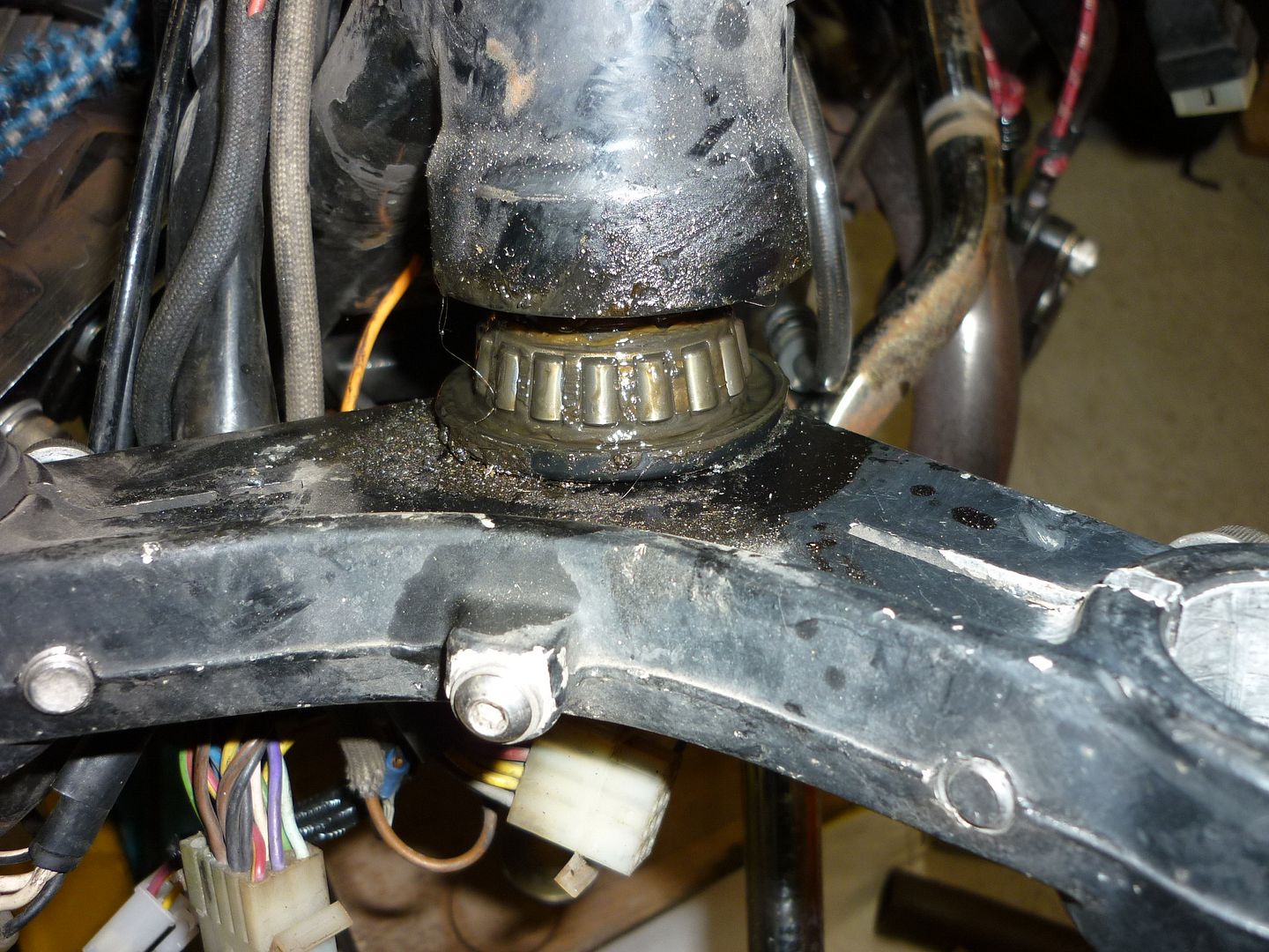

I am having trouble removing the steering stem from my T4 ('81 model) - same as T3 model essentially.
I have stripped everything from around the area to get a good go at it but still cannot get the steering stem to budge.
I have removed the top triple clamp, the staunchions, the top nut and bearing cover and according to the manual it has tapered bearing. Tapered bearings in my experience just come apart without any fuss.
With the top nut replaced I have severly tapped the top of the stem with my lump hammer and it appears to be as solid as a rock. No downward movement at all.
See view in pics of bearing from the top with rollers visible, but alas no movement.
Picture below shows no movement at all.
Have I missed something? Is there an Italian trick that has been used that I am not aware of?
Help is required from people who know about these things. It's different from all the other steering heads I have removed.
Thanks for any and all help offered.

Re: Help to Remove Steering Stem on T4 Model
« Reply #1 on: August 10, 2015, 07:02:43 AM »
Original bearings by the look of it. They've been in there for thirty five years my guess is they are rusted to the stem. Give the stem a good soak with penetrating oil and leave it overnight then ge a block of hardwood to put on top of the stem and try a few really good whacks to get it moving. DO NOT beat directly on the stem with a lump hammer! You'll mushroom the tube, damage the threads and render it useless.

I had to do that to the T5 when I replaced the head bearings.  Took a few good smacks with the hammer to get it free of the bearing.  Had to cut off the lower bearing race (dremel tool).

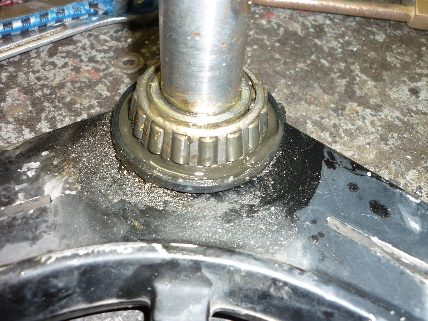

« Reply #3 on: August 10, 2015, 09:05:01 AM »
Had this same problem when I removed mine (81 G5). Seems to be (from my conclusion) that it's a problem with this generation lower triple tree (fat leading edge).
What worked for me:
1) Be sure the frame is on a solid surface (kick stand isn't solid enough, so maybe sit the entire frame on the floor)
2) Use some sort of soft metal plate to protect the tube (I used a brass door hinge), thick aluminum anything like that. Also put the nut on it so you can unscrew it to fix the threads if they get a little messed up.
3) Use a clob hammer and strike hard. Not rubber or wood mallet (the one shown on the floor in one of your pics is perfect)
After removed, you may need to use a dremel as suggested above to get the lower bearing race off. Once the bearings were both off, I sanded the areas where the bearings go so I wouldn't have this problem again in the future. Check often with the sanding as that tube us actually very soft metal.
Good luck.

  • Posts: 21220
« Reply #9 on: August 10, 2015, 04:13:19 PM »
The problem is that the steering stem is stuck in the TOP bearing inner race.  If it's not simple rust, then it could well be a burr or chunk has bound the shaft to the race.  If you can get a puller onto the top of the stem (or somehow get constant, significant pressure on the stem with some sort of press) you might be able to then tap on the top bearing inner race with a drift and shock the stem free.
Finding a safe way to heat the top inner race might also help.
I'm only tossing these ideas in because nothing else seems to be working for you.  I wouldn't suggest these solutions for normal circumstances.

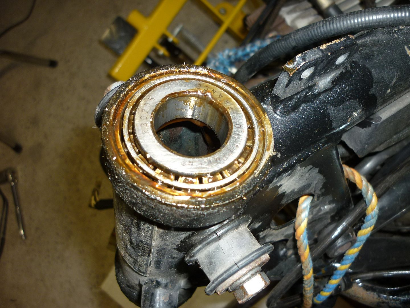

« Reply #11 on: August 10, 2015, 04:17:22 PM »

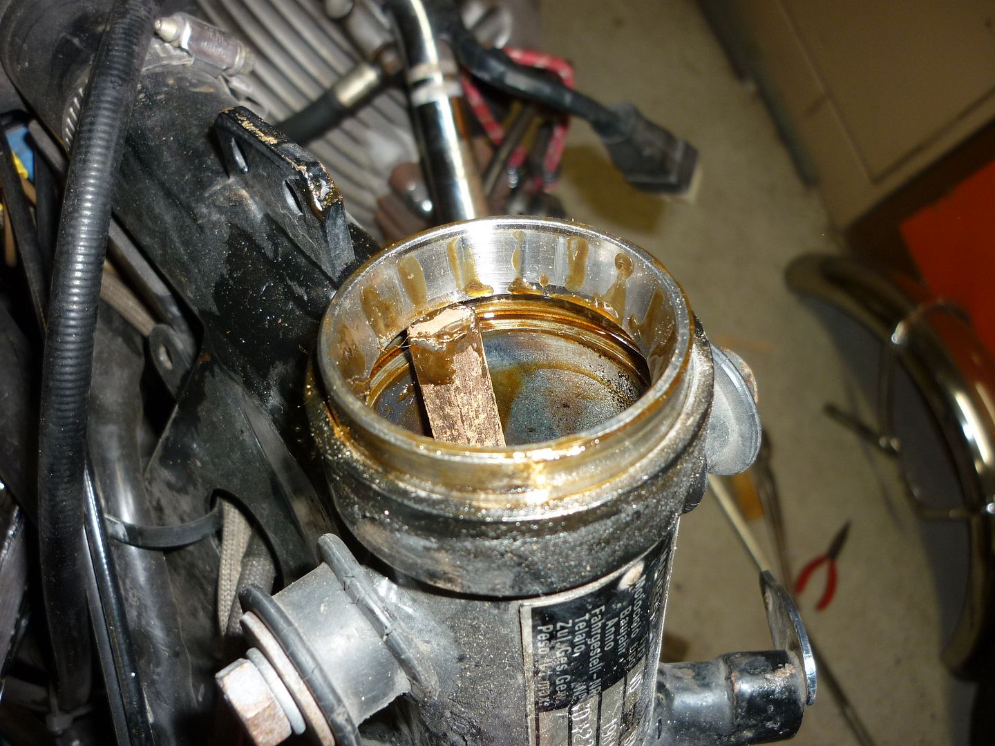

Mine wasn't rusty, was just tight as S%*T
See image. The one to the left is mine (the super tight one I was having a problem removing like yours), the one to the right was off a different Tonti frame (T3 I'm guessing)

  • Posts: 318
« Reply #12 on: August 10, 2015, 04:20:31 PM »
See image. The one to the left is mine, the one to the right was off a different Tonti frame (T3 I'm guessing)
Yes mine is like the shaft on the left with not as much thread on the top.
I sprayed it with WD40 this morning before I left for work (4.45am) and plan to pick up some penetrating oil on my way home this arvo.
Cheers

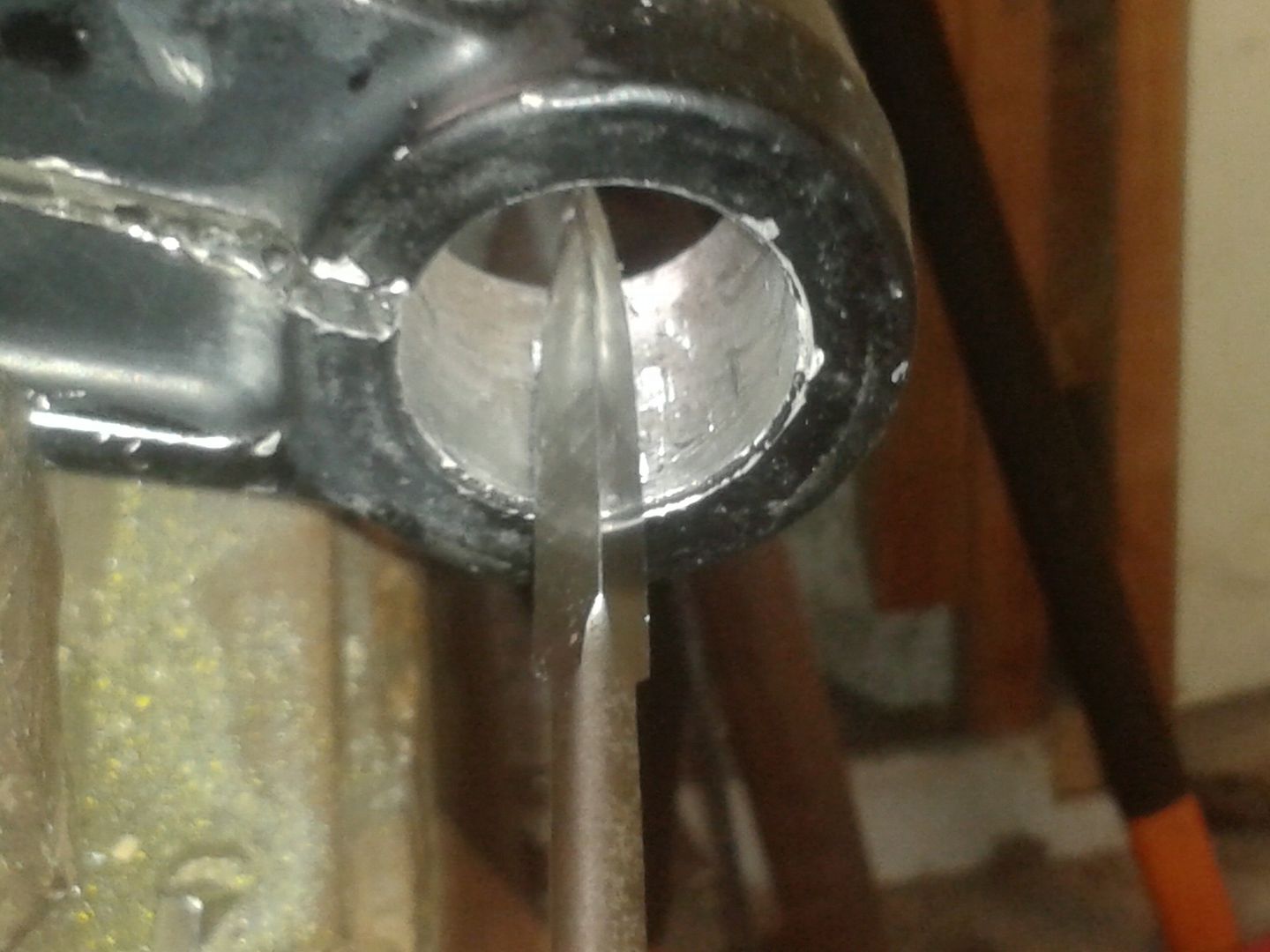

« Reply #16 on: August 10, 2015, 05:09:35 PM »
I'd be really surprised if none of the above work and you still have a problem.
But plenty of soaking with penetrating fluid not WD40 is definitely part of the solution.
If you are getting nervous about the amount of force you are applying to the stem, you might want to consider several sharp blows with a centre punch around the inner race.  It'll either jolt it and free it or it'll shatter it and free it up.
You'll need to be careful not to damage the headstock. Certainly only do this as a very last resort and   make sure you don't strike the outer race.
Failing that a dremel cutting disc looks like the final option.

Offline Guzzi_Don
  • Posts: 318
« Reply #25 on: August 10, 2015, 08:27:16 PM »
Some information in this linked thread from when I had this same issue:
http://wildguzzi.com/forum/index.php?topic=75788.0;nowap
Hope that helps.
Thanks Groover for the link. All links are appreciated on how to accomplish this task.
Different ones on here have mentioned using a Dremel and cut off wheels to remove bearings. Could this be explained in more detail?
Cheers
Don
1981 Moto Guzzi 850-T4
1977 Suzuki GS550/700
1991 Suzuki VX800
Online rodekyll
  • Posts: 21220
« Reply #26 on: August 10, 2015, 08:31:15 PM »
That's for after you get the stem out.  The lower bearing race is traditionally the stuck one.  You can either figure out a press plate for it or cut it off.  A lot of us go straight to the torch or cut-off wheel rather than trying to finesse the race.
I don't think you'll get the cut-off wheel to work unless you can first move the bearing out of the headstock.  If it's still bound after it clears its pocket, then some cutting tool might help.

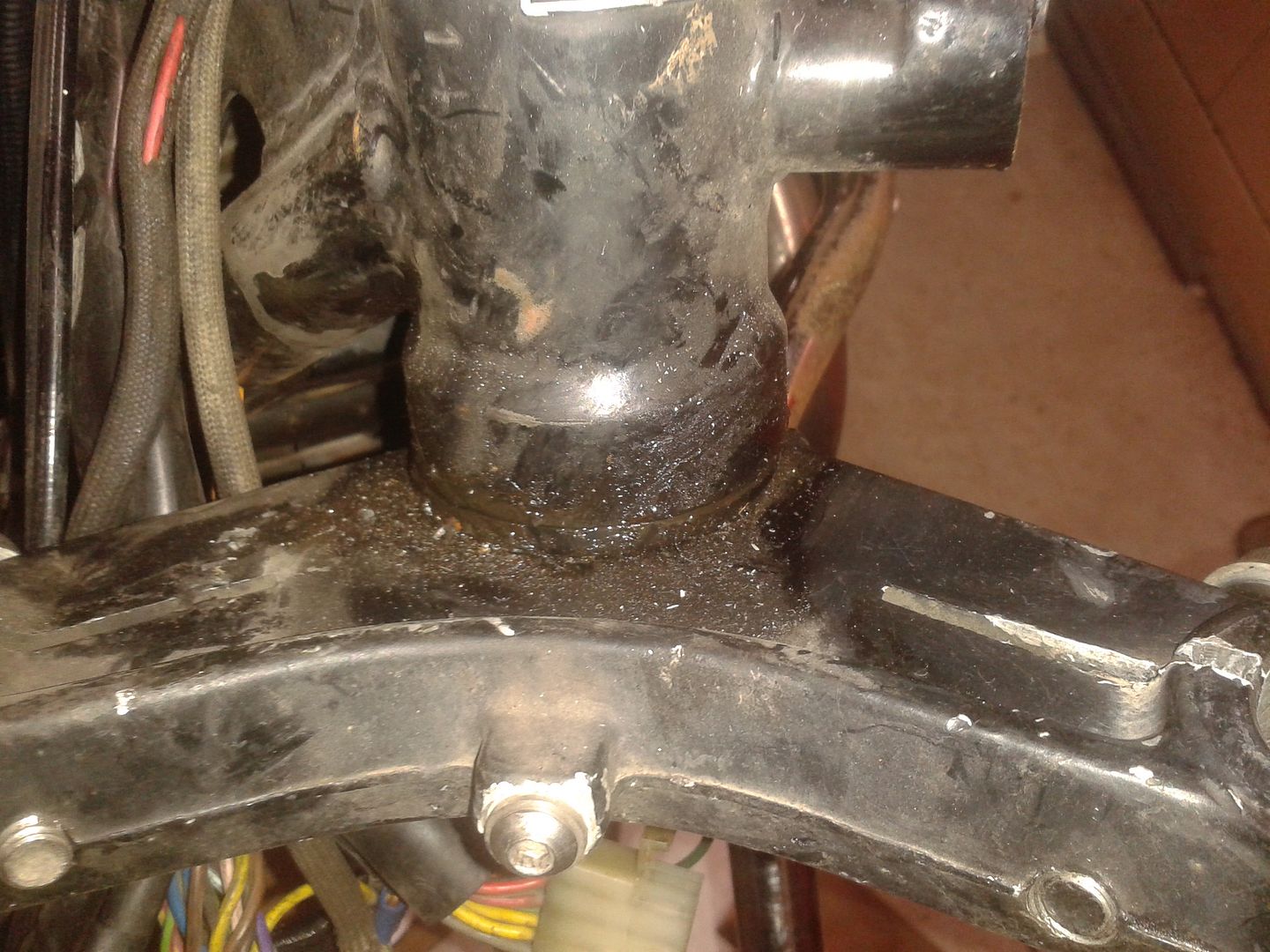

Offline SED
  • Posts: 1629
« Reply #27 on: August 10, 2015, 08:37:59 PM »
From the first photo it looks like the steering is locked.  If so it is going to lock the stem in place.  Can you turn the lower tree?  Apologies if I missed something.
1983 LeMans III
1981 Monza
1947 Ariel Red Hunter
1939 Ariel Red Hunter
1937 Guzzi GTV
Offline Guzzi_Don
  • Posts: 318
« Reply #28 on: August 10, 2015, 09:28:47 PM »
Refer to Reply #20
Cheers
Don
1991 Suzuki VX800
Offline Guzzi_Don
  • Posts: 318
« Reply #29 on: August 11, 2015, 08:38:32 PM »
An update for those interested;
I took the two fork tubes around to my tool maker friend and it turns out the LH fork tube is .002" bigger than the RH fork tube. So armed with a scraper that my friend loaned me I went home and enlarged the lower LH triple clamp so the fork would fit reasonably well. Pic below.
Then I moved on to the next job. I had bought some acetone to mix with ATF fluid to soak the steering head bearing area overnight. But prior to doing that I thought I would give it one more attempt to drive the steering stem out of the headstock. Lump hammer and piece of hardwood at the ready and with the forum advice to give it some serious thumps off I went. To my amazement on the 3rd whack I felt something move, so more whacks and there was a little more movement until I got to this stage and had a rest.
Steering stem out finally after a bit more effort from me.
Next I drove the outer bearing shells out of the headstock in the frame. Fortunately they both came out without much effort. See below.
Now the next task is to remove the lower inner bearing from the steering stem. See below. Not looking forward to that one. All offers of advice welcome.
I have ordered all the relevant parts to complete the reassembly, bearings, seals, etc.
I do have to attack the steering stem though where the top inner bearing seats as this diameter is .0047" larger than the ID of the bearing which in anybody's language is way too tight. Goes along with my theory that they threw the T4 models together with left over parts without checking anything too much. With the upper bearing that tight it would have been impossible to do any steering head adjustments over the years. BTW there was no corrosion or rust in there as can be seen in the pictures. The bearing was just way too tight on the stem. So the stem has to be reduced to a smaller size which I will do when the new bearings arrive. Might use a belt sander to do that task me thinks.
I could do with some advice on the front forks and their disassembly. When I had the forks on the work bench at my tool maker friend's place I pulled on the staunchion to check for sideways wear of the tube in the lower half and the tube pulled completely out of the lower leg. What was holding it in place -- NOTHING.
Any suggestions on how to remedy this? What has happened? Am I going to have trouble removing the allen bolt from the bottom of the lower leg?
I have ordered new seals for the lower fork leg as well.
How do I disassemble the fork legs? Obviously I will have to disassemble the LH fork leg to see how it goes together so I can piece the RH leg back together in the correct order.
ALL advice appreciated.
Thank you very much.
« Last Edit: August 11, 2015, 08:48:39 PM by Guzzi_Don »
