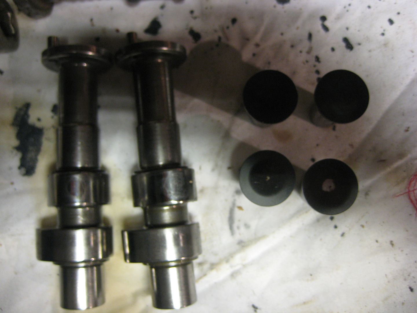

Here is a couple of pics. Interesting the one tappet that looks scratched as if it weren't spinning. My homemade valve tool,did the job. All in all I'd call myself lucky. Thanks Mark, I think I'd like to keep the original closed loop and give it a try, I'll pm you an e mail,many thanks.   dave.

Pete do you think the extent of wear I found warrants further fussing? No roughness to the surfaces at all, but obviously  some dlc missing. 6000 miles, who'd have thunk.

Next oil change drop the sump and give it a good clean out but with such minimal wear at such a low mileage I think it would probably be uber-paranoid to do the full back-flush etc.
Others opinions may vary.

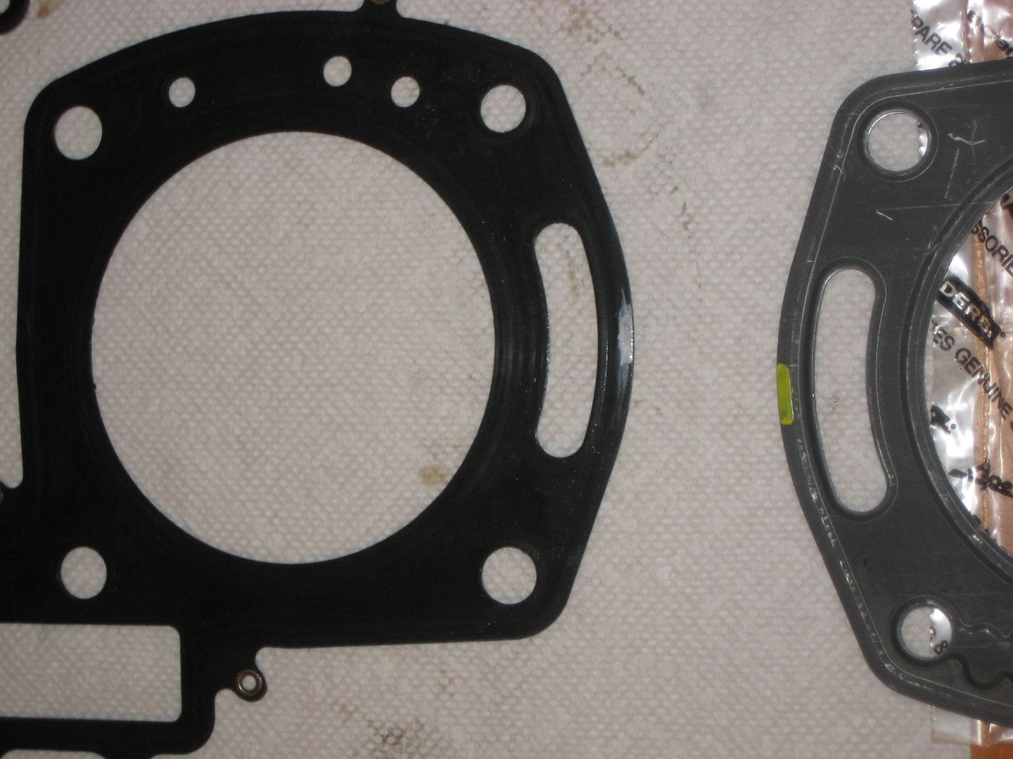

My Griso required the thinnest of the three head gasket choices, marked with a white dash, I have the other two sets as they came with the c kit I purchased, If anyone can use them let me know, I think Pete said the middle one will work for most.  Dave

Where are the marks on the gaskets, and can you find it on the used old ones?
My kit had the middle one only, nothing to choose.

I'm not sure exactly when they started colour coding the gaskets Paul, certainly not in the first couple of years of production. The way it seems to be done is when the new gaskets are stacked upright in boxes or racks someone just runs a paintbrush down the edge of them on the side that faces *Out* from the bike.
From memory it's white for the thin ones, yellow for the intermediates and the thick ones are left unmarked.

Paul, they are marked with a  dash on the forward most point on the top surface,white being the thinnest,yellow the middle and the thickest has no marking.
The packaging was numbered as follows
thin dis. # 874621
 Middle dis. #874622
 thickest dis. # 976311
 Was yours a c kit?

While it maybe less than brilliant, I see no reason why one couldn't reuse one of these types of gaskets. I would shellac it and slam it right back in next time.

well no paint marks on my old ones. And the C kit came with one set, not three sets, someone made me the choice easy. Did they in the beginning suppose that each time one takes of a head, you are going to measure with the special tools?
