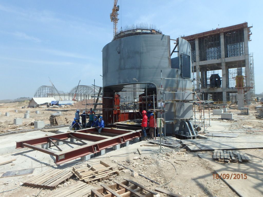

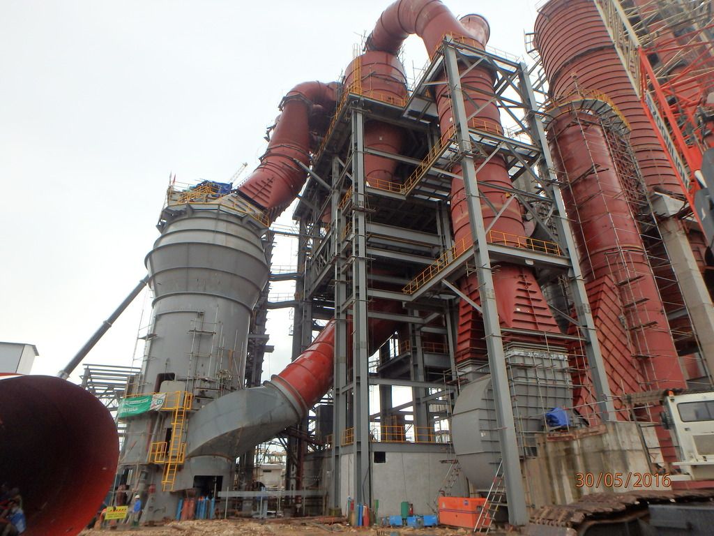

From this:
To This:
99,99% of what you see here is done by stick welding.
It is a limestone mill capable of crushing more than 8000ton/day of raw limestone into powder , btw :grin:
My little work project :grin: you can see the scale by the worker in the blue on the bottom picture.
