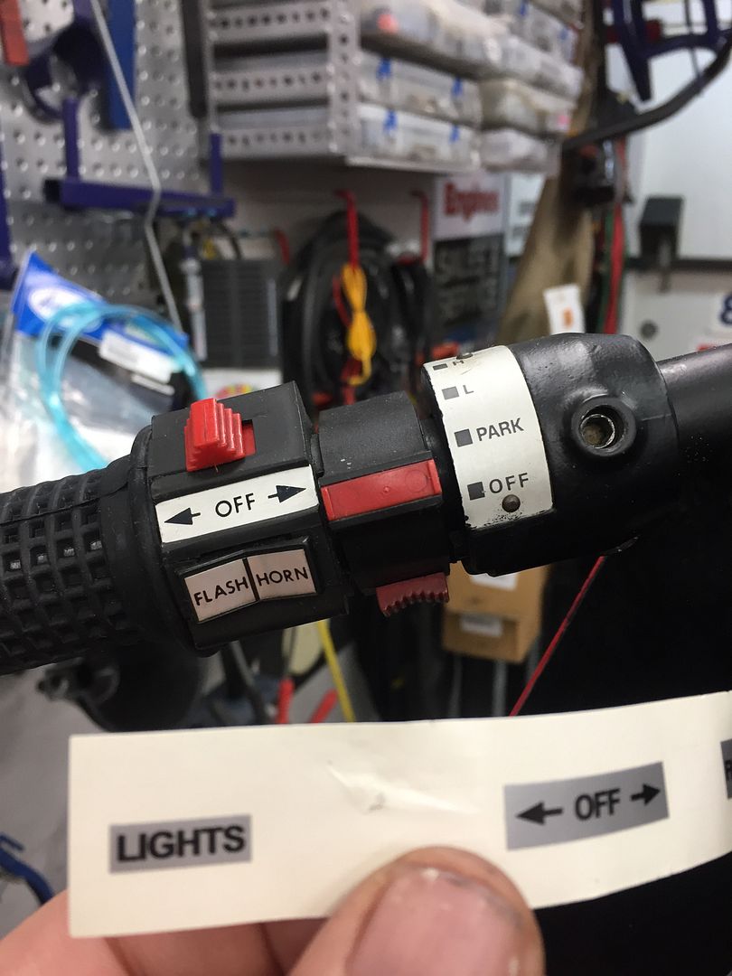

Fitted a pair of new repro rubber hand grips, the original type that have almost no padding and leave your hands numb
And I had a set of repro decals for the original switches, some of the original decals were missing or faded out, these are a decent match and cheap
Gregory Bender made me a complete new wire harness and all of the sub harness kits, Greg makes perfect copies, if you are rebuilding a Guzzi Greg can make a harness for you, all models.
http://www.thisoldtractor.com/for_sale_wiring_harness.html
I fitted the main harness, the sub harness kits yet to go in
