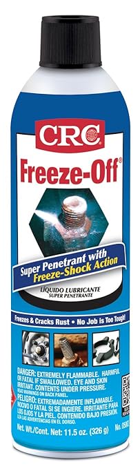

  • Posts: 14800
Re: 850 T-3 Front engine through bolt question, need help
« Reply #23 on: August 22, 2018, 08:37:23 PM »
All of the above + this stuff. It really works.

Online John A
  • Posts: 5335
« Reply #25 on: August 22, 2018, 08:51:14 PM »
I didn't know that existed, thanks. When I worked at an airline we had some stuff called Instant Chill for finding thermal intermittants . It was great fun when you happened to have a can when you walked by someone on a ladder :evil:
elvisboy77
« Reply #26 on: August 22, 2018, 09:36:38 PM »
Ooh I like it.  I am going to try the torch first.  Crabbed the frame enough to remove transmission from engine.  Clutch plates look great except that they all have a huge coating of oil.  Hoping this is a simple main seal and clutch replacement.....the clutch would not disengage and grab when I decided to take it apart, assuming this is oily clutch and gummed up splines?
