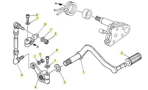

Re: local temperatures, it's between 10C and 15C here in Victoria BC, so I don't think that's a major factor.

Try a TAD tighter. Make sure that when the lever is held to the grip it is truly releasing the clutch and allowing the input shaft to stop spinning.
Just make sure it isn't so tight that it allows it to slip when you let go of the lever.

However, when Steamdriven and myself had the box apart (again) to replace the Mk11 pattern pre-select mechanism that was not supposed to jamb but did, we saw that the one noticeable area that the V7 box was different was in the style of that pre-selector mechanism. Don't know whether it has any bearing on the problem but it begs the question why MG have had three different iterations in basically the same box.

Check for any slop or looseness in the shift linkage - I had trouble shifting for a while until I found my shift arm #9 in the diagram, was loose. I had to replace the fastener #6 with a new one.
Check for any slop in the linkages!

And on my 1100 Sport, that shift arm would no longer grip the spline. Removing some of the metal with a 1mm disc in an angle grinder widened the split enough for the bolt to grip. Got me back on the road again (in the pouring rain on the west coast of NZ's South Island, thanks to a friendly local).

OK, only because he's tried everything else shy of removing and opening the box, here's the last adjustment (the arm on the transmission):
Pete Roper:
 OK. Firstly, unless you have an issue leave it alone!
 There should be a couple of mm of movement at the lever on the bar before you begin to feel resistance. This is the free play needed to prevent the arm riding the thrust bearing and constantly pre-loading the clutch. I know a lot of people like the clutch lever to feel 'Firm' and not move about in the perch but this is actually bad for the system. You have to have that free play!
 If you have the handlebar adjuster on the perch backed all the way out and there is still TOO MUCH free play at the bar? Then and only then do you need to frig about with the difficult to access adjuster on the actuating arm on the back of the gearbox.
 In the case you cannot get the free play right with the perch adjuster proceed like this.
 1.) Turn the perch adjuster 3/4 of the way in towards the lever increasing the free play.
 2.) Grab a 13mm spanner and I think for a V7 of your vintage a 3mm Allen key and lie down by the bike. Make sure it can't fall on you while you're messing about. If you have a lift? Elevate the bike appropriately.
 3.) Loosen the 13mm locknut on the arm adjuster and then using the Allen key wind the adjuster IN towards the engine until resistance is felt. Back it off about an eighth of a turn and lock up the locknut.
 4.) Slither out cursing from under the bike and go round and feel the free play in the lever on the handlebar. If it is close to the 2mm of free play you are aiming for simply use the perch adjuster to get it right and you're done. If it is too tight? Get back under the bike and loosen the locknut and wind the arm adjuster out a smidge more. If you still have too much play at the lever wind the arm adjuster in a bit and lock it up again.
 5.) Repeat step 4 until you have the free play correct and most of the adjustment at the perch is available for tightening in service. This will coincide with your being really dirty and pissed off but life's like that.
 6.) Put 13mm spanner and Allen key back in toolbox, curse, brush off as much grot as possible from your clothes and go to the fridge and crack a beer.

I gave this a go and but when I had a look for the "arm adjuster" near the transmission, I couldn't see one.  The clutch cable appears to be connected directly to the clutch release shaft on the transmission.  Not giving up, this weekend I took my bike to a local motorcycle coop for some advice.  After a quick spin, the mechanic suggested that my shifter linkage is indeed sloppy and that the problem could be a failed shifter return spring....the spring near the letter "A" in the image posted by Penderic above.  I'm going to let coop's mechanic have a closer look next week...

Just a quick update to say that the coop's mechanic was right.  The shifter return spring had failed but ... because it wasn't completely broken, it would work intermitantly.    So having had the spring replaced, I'm a few $hundred lighter now .... but things are working nicely again.
Here's a photo of the offending part.

Awesome! Glad to hear and thanks for reporting back!!!

Correct.  The first pre-selector fork did not last long in production at all.  Mine is a 2003 model and it had the later one fitted. It was just bad luck that I got a 2nd generation one that just happened to be able to jam.  Before we installed the 2nd hand one that Pete sent over we tried to get it to jam but could not.
OJM, that is the first spring break that I know of to happen in the small block gear box. Simple bad luck.
