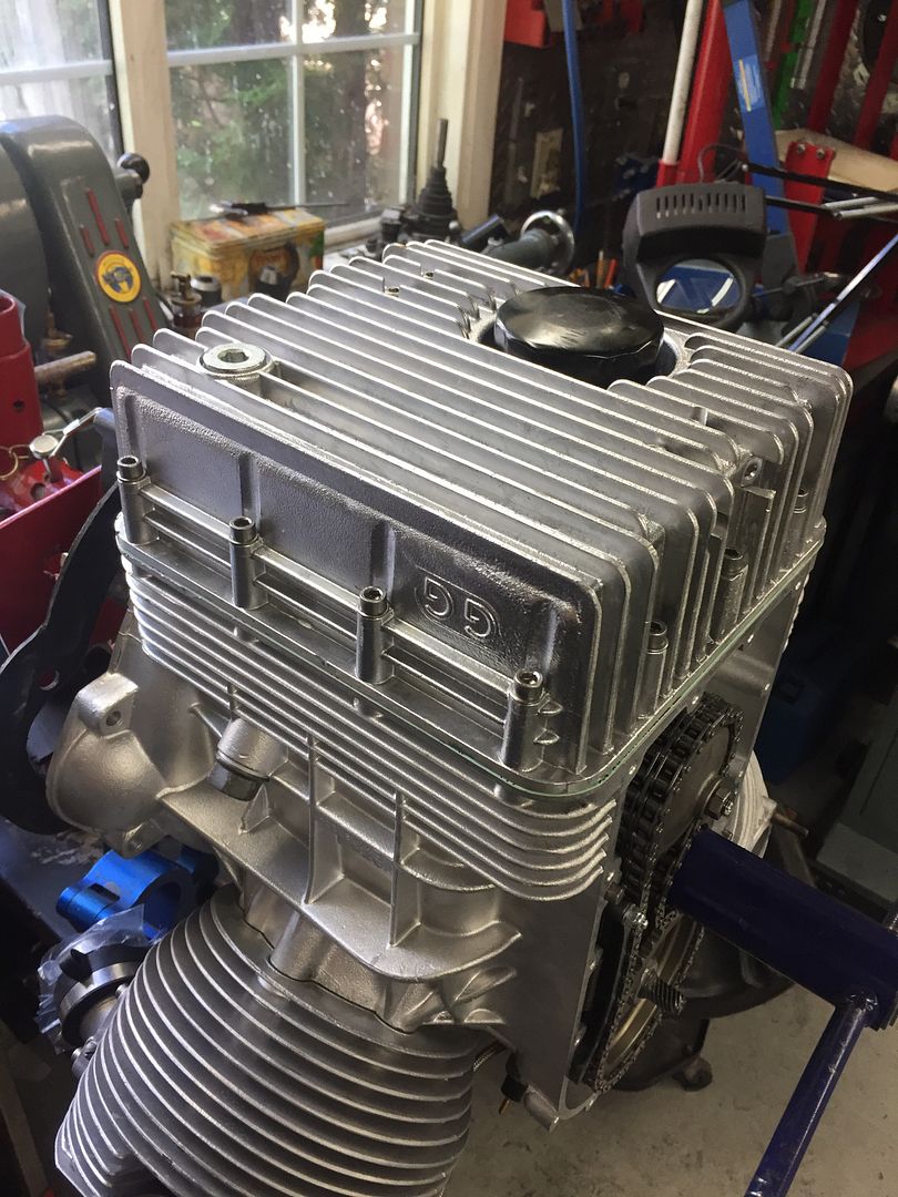

Fitting the sump, flip the engine upside down and place a gasket down
I am installing a deep sump outside filter unit, new stainless fasteners and all torqued down
Check the gear timing marks and then I attached a dial gauge to the back of the crank, inserted a piston stop into the left spark plug hole and confirmed TFC on compression on the left 'S' cylinder
Pulled the engine off the build stand and onto the engine holder
Grease the tach drive gear face on the cam
Install a front cover gasket
Pop the cover on with a new seal for the alternator
Use the correct hardened steel bolt for the alternator and a schnor washer
Install the rocker gaskets and rocker covers, new fasteners, torque the covers down
With the engine sealed up I pressurized the case to 60 psi and checked for leaks, soapy water on the back of the breather tubes, no bubbles
The paint mark on the back of the crank should line up with the cast pointer in the back of the crankcase,
I made a mark on the flywheel before I removed it to know where the flywheel should bolt on and marked it with a new paint dab
The 'S' mark should be in position to be viewed through the transmission inception plug
This mark should align with the pointer on the crank case
Torque down the flywheel with schnor washers
I put a dab of glue from a hot glue gun onto the back of the clutch springs to hold them in position until the pressure plate is in place
Check the pressure plate recesses on the back are aligned to the springs, the mark in the pressure plate matches a mark on the flywheel, I repainted the marks
Then tighten down the clutch plate alignment tool
new clutch plates and an intermediate plate
Then the ring gear can be attached, schnor washers again
And the clutch rod mushroom pops in to place
Stator fitted
And the air spacer and cover, haven't decided if I will polish the cover, I think the original Le Mans where not polished??
OK that's one motor built

Looks like the flywheel bolts are 8.8? You really need higher strength 10.9 bolts in that application. 8.8 are fine for the ring gear though.
Re: 1977 Le Mans Rebuild getting started
« Reply #94 on: July 04, 2017, 08:38:11 AM »
Thanks Charlie! I will check the bolt grade.
Great eye Charlie, like you thought the bag of bolts I was using are all 8.8, I bought a box each of 50 - 25mm and 20mm  - 10.9 high strength bolts from my local bolt supply shop.
Tossing out the old 8.8's this evening!
Thanks again for letting me know, shearing flywheel bolts would not have made for a good day.

Looks like you have 4 of each - 8.8 and 10.9 on the ring gear. Or maybe four are zinc-plated and four are black oxide.
« Reply #102 on: July 05, 2017, 10:25:20 PM »
10.9 bolts installed on the flywheel and ring gear,
Mated the transmission to the engine
And this time I stamped a rebuild date onto a non-descript location on the engine block
and the back of the transmission
Chances are this Le Mans will not need to be rebuilt again and 40 years from now when this bike is 80 years old some future owner may want to know when it was rebuilt
