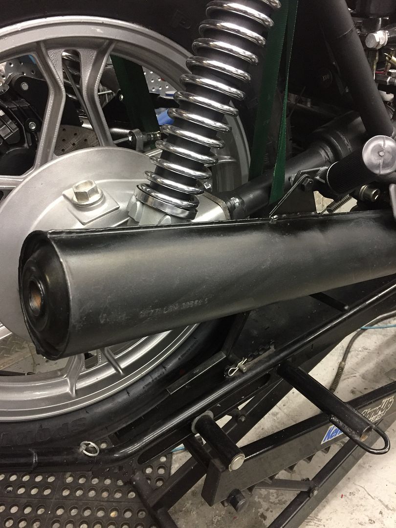

I fitted a new pair of LaFranconi reproduction mufflers, the reproduction is so close to original right down to the shamefully terrible paint job
Left Side too shiny, right side dull and patchy
The paint on the mufflers is so lousy it starts to wipe off with wax remover!!
I will take them off and get them ceramic coated, really disappointed in how LaFranconi can sell a new pair of mufflers so poorly finished!

Installed the tachometer cable
Terminated the front signal light leads and placed the signal light ground wires on a frame lug
And fitted a round female plug end onto the oil pressure sender wire
MG Cycle has the choke cables back in stock so once they arrive that should be the last new parts I need to fit.
Then to fit a battery and start checking all the electrical is working.

You are really doing a great job on this bike, it's getting a lot of love! As far the caps go, the OEM plugs for the swing arm caps were rubber originally and would actually work at snapping in. The new repro ones out there are hard plastic and don't really work (as you found out too). I don't think they snap in on the steel oem caps either, do they?
With the plugs being pre-snapped in like that, how are you going to fine tune the swing arm bolt adjustment? Sometimes tightening the cap will also spin the swingarm bolt making it too tight, so you might need to hold it with and Allen wrench and use a wrench (not socket) to tighten the cap, which brings me to another point... if I remember correctly, those tighten at a pretty high ft/lbs rate, and in my experience SS doesn't do too well in those cases. Might be ok in your case being those are large diameter bolts. I just question reproduction SS hardware out there on the market a lot after learning their properties (pros and cons), and I just wonder if they actually test their applications properly, or do they just make SS 'stuff'.
« Last Edit: November 29, 2017, 07:05:52 AM by Groover »

Ok, just looked up the torque specs, and it looks like the caps tighten at 57 ft/lbs. I thought they were ones with crazy high 120 or so values.

The stainless steel cap nuts have a thicker body to the top, the depth of the hole is deeper so neither the original rubber plug or the new plastic ones will properly fit. The design is a carry over from the Loop Frame bikes that used a pivot pin that has two holes drilled into the face to accept a 2 pin wrench that can only be fit with the cap off. I don't believe that Guzzi intended to use the cap plug as means of adjusting the pivot pin. I think the purpose of the cap is to lock the position of the pivot pin. I replace the 2 pin type pivot bolt with the newer socket head design, much better than the original 2 pin or the later flat blade type adjuster pin. When I install the pins I oil them and tighten them right up then back them of just a smidge, fit the cap finger tight then give it a twist with a great big open end wrench. I agree that stainless steel is the not the right product for a stressed fastener but the large diameter of the cap probably equates to significant strength for the specified torque, and it looks pretty :wink:
